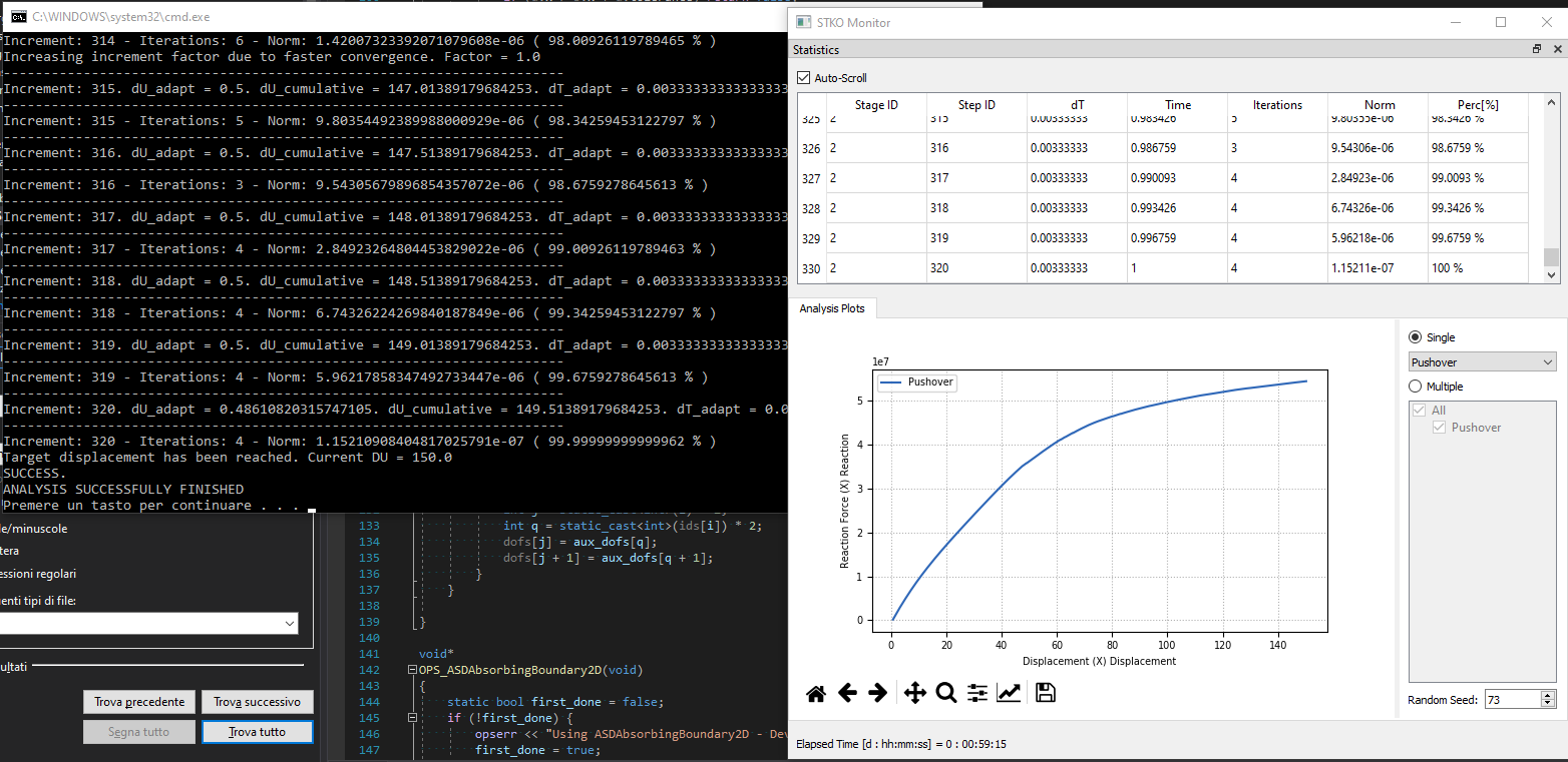

Re: Pushover analysis error
Post by STKO Team » Wed Sep 15, 2021 9:02 am
I cannot find the error.
The analysis runs smoothly till 100% and I can see the post results as well

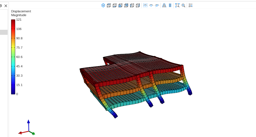

How can I model the slab with a plastic plate with a reinforcement inside (distribution net)?

I am attaching the model that I am trying to make work, but I know that I will have to change the "materials plastic damage concrete plane stress"

I have the following suggestions for your model:
- PlasticDamageConcrete3d is really difficult to calibrate, I couldn't find any literature to study either so I would not be able to help it use it. I suggest you to use DamageTC3D, I input default parameters in your model that I attach here and you can study the following article to know more about how it works.
https://www.researchgate.net/publicatio ... hear_walls
- as the material you picked for the rebars is not correct, you should use the PlateRebar instead. There is a shear wall example modeled with Layered Shell and PlateRebar on our website (Massimo's webinar #02) and the same concepts can be applied to a slab.
Anyway even with these modifications your model does not run, was it working before?
