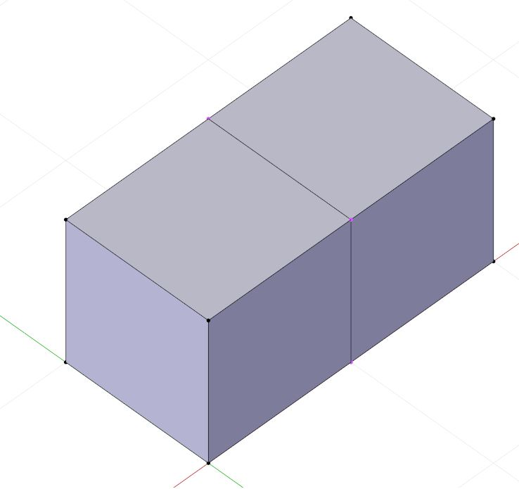

I am trying to analyze two blocks placed side by side with the ASD interaction in between.
I want to first apply gravity load and then push one of the blocks upward as explained in the figure below.
After the application of gravity load there should be some friction between the solid elements.
However, I am pretty sure I didn't define my analysis steps correctly. I first apply fixed supports at the base of both elements and then I remove the supports only underneath one of them (the right one) after the application of gravity load. However, this doesn't seem to work. Can you please advise how to do this?
I have attached the model as well for your convenience.

I see some problems here:
  • The contact normal vector should be the global X axis, but you did not assign any local axes to the interaction, so the contact will not work, since the default contact vector will be Z (without a local axes)
  • When you remove the fix at the right block and apply a load, the right block will be singular (I replaced the pressure on top with an imposed disp at the bottom face, applied after the fix is removed)
  • Accidentally you selected also the right edge of the left bottom face in the fixbottomR condition, so when you remove it also the left face will start being singular in rotation about the Y axis
  • Now it works but I'm confused about the monitor.
  • The stiffness of the contact should be higher then the stiffness of the block (E*size_block)
If you really want to test the behavior of contact (shear force-displacement under a certain normal pressure) this is not the right benchmark (the pressure should be normal to the contact sliding plane).
See our webinar on contact, there are some benchmark there similar to what you are doing here. But with one block on top of another

Thank you very much! Could you please remove the file from the forum? Also...
This is my mistake, I apologize.
Thanks, I will look into this and follow up if I have more questions.
For some reason I couldnt select the face only. I remember struggling with this. It is strange because I was able to do it for the left block.
The monitor was not finalized. Thank you for noticing.
OK, thank you.
Thank you very much for your help!

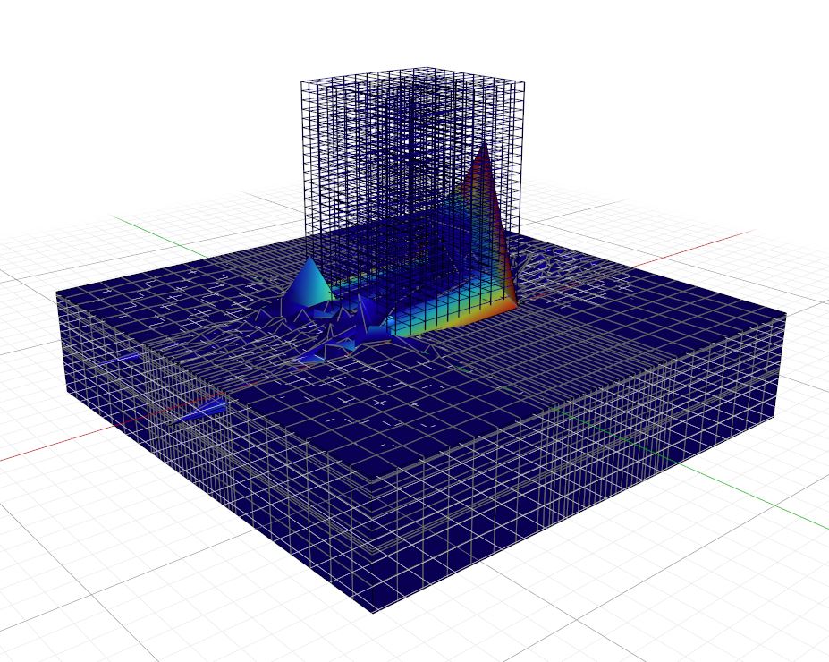

I am modeling a full SSI problem with a frame building, pile foundation and a soil domain. This is the same building model from "Issue with Modal Analysis of a Frame Building" thread. The model is quite complex with complex pile geometry, contact elements, and soil layers. When I ran the model, the analysis is blowing up, as you can see from the deformed shape below.
Can you please take a look at the model and let me know if anything stands out? Also, any suggestion on how to tackle this problem would be useful.
Here is the model for your convenience.
Thank you very much.

It appears that using stdBrick instead of sspBrick resolved the issue. Thanks

Yes I was going to answer just now.
When you see a hourglass-like deformation pattern is (almost) always due to under-integrated elements and the propagation of spurious zero-energy modes (for this reason called hourglass modes)
