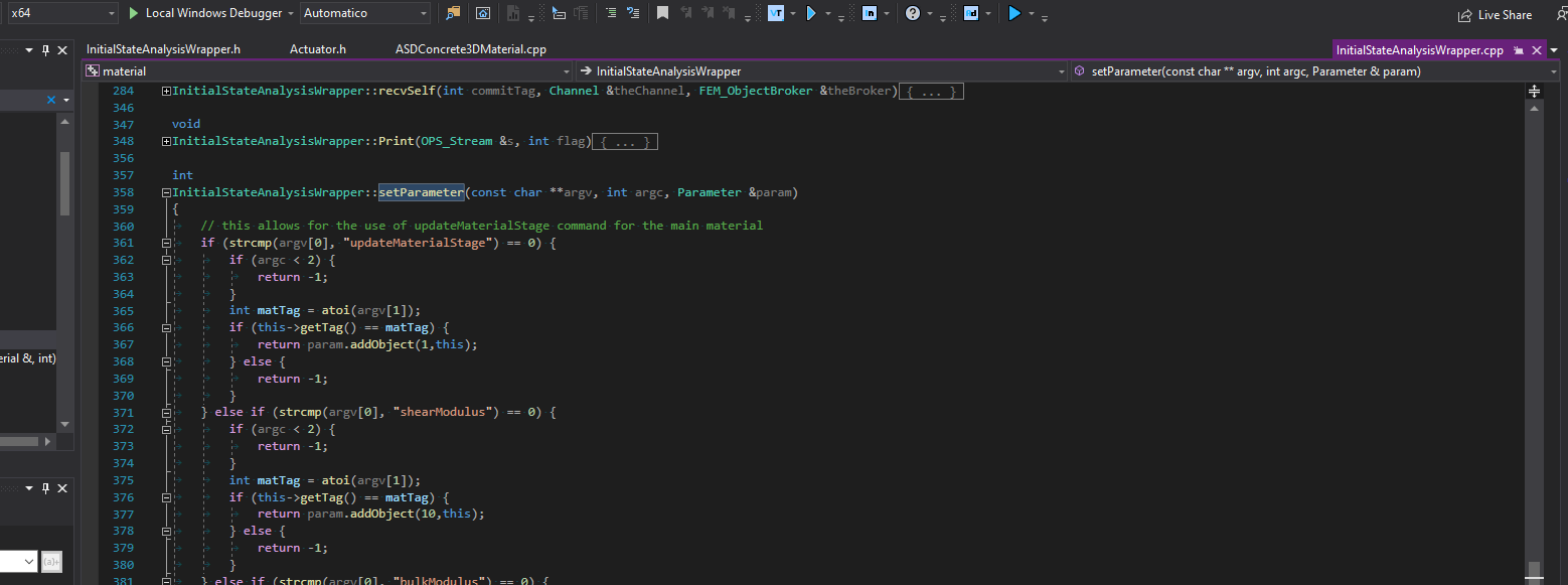

The InitialStateAnalysisWrapper does not support the "materialState" keyword for parameters!
The BoundingCamCly material needs "materialState" to enter the plastic stage.
Is there another method to conduct the initial analysis with BoundingCamCly material?

The initialStateAnalsysis is only useful when you are doing stage analysis and you want to reset the initial displacement to zero while keeping the initial stress.
Anyway it's not mandatory, just don't use it.
If you want to build other pieces of solids like in a construction stage there are other ways to do it without the initalStateAnalysis Wrapper
Actually, this is exactly the functionality I need. Is there any way to accomplish this?
