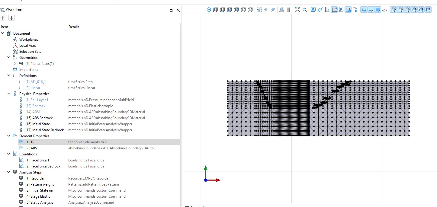

The problem why you couldn't run it was that when you assign your triangular_elements you selected not only faces but also edges and nodes. I reassigned it and now it runs.
Screenshot 2023-05-22 094005.jpg (176.71 KiB) Viewed 1786 times
But now it asks you to insert peakShearStra for PressureIndependMultiYield
