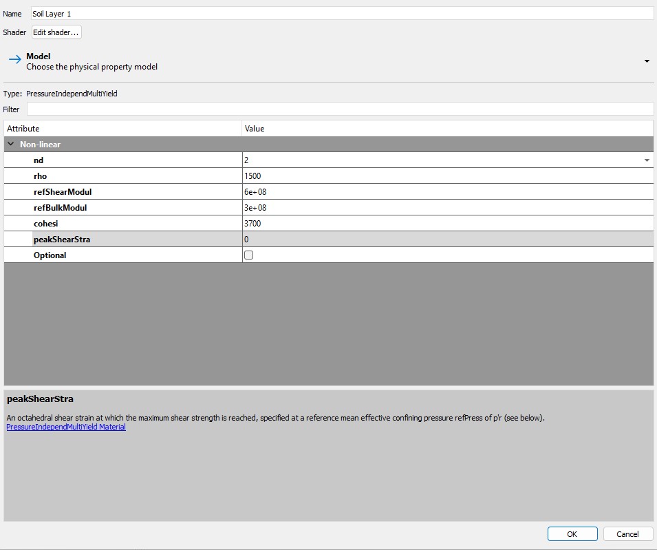

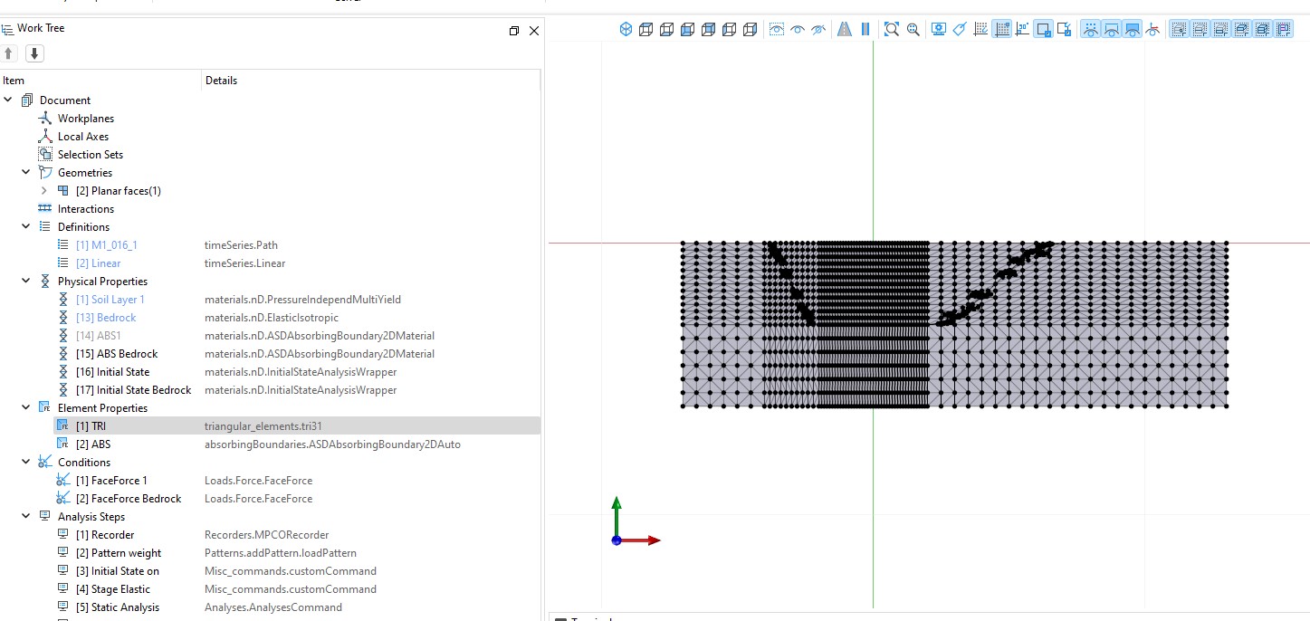

The problem why you couldn't run it was that when you assign your triangular_elements you selected not only faces but also edges and nodes. I reassigned it and now it runs.
But now it asks you to insert peakShearStra for PressureIndependMultiYield
Let us know if you need help
