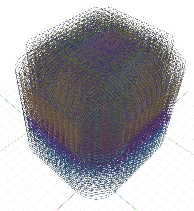

2) I am using Custom section and I enter the values of sectional properties manually for all sections. However, it seems that the graphical representation of these sections is totally off and they all appear very large, as shown in the screenshot below. This makes is almost impossible to use the model since I cannot see well beams and columns Is there any way to control the size of the section in the graphical representation when Custom sections are used?
The graphic representation of a custom section is a circle with the area you specify. Did you specify a very high Area to simulate a stiff element?
