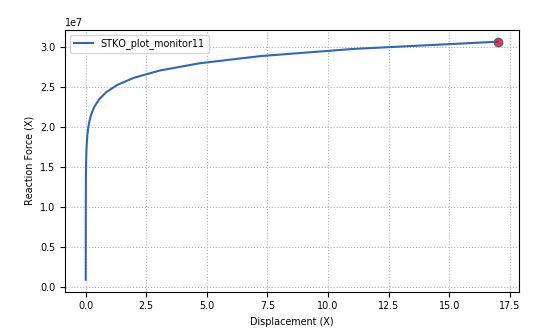

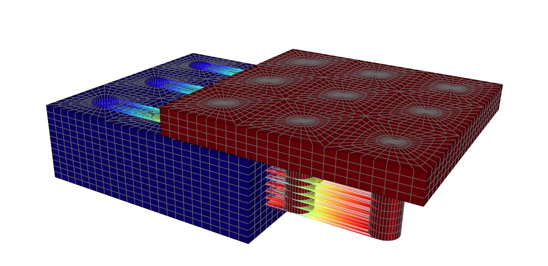

Hello, I have worked on expanding my model of a single pile to a model of group of 9 piles. I used the same model as previously discussed in this thread and simply copied it 9 times and made appropriate modifications of boundary conditions. I also added a pile cap that connects all piles together. You can see the geometry of the model below.
When I run the model it appears that contact between the soil and the piles has issues. As you can see in the figure below, the piles simply penetrate through the soil.
You can also see from load-deformation curve, that this penetration is not happening linearly. The model starts with a stiff response, as it should, but then the penetration starts increasing exponentially.
I tried many different things, such as changing the slave vs. master geometries in the interactions, checked local axes, played with the Kn and Kt stiffnesses. Some of these attempts did impact the results, I cant seem to get a reasonable model response.
I attached the model and I would really appreciate if you could take a look. I am almost certain that the issue is with the modeling of the contact.

Re: Soil-Pile Interaction Modeling
Posted: Mon Mar 04, 2024 9:48 am
You forgot to assign local axes to your node-node side interactions.
But pay attantion: the cylindrical local axes if valid only for you first pile! the cylindrical and spherical local axes are location-dependent.
So you can either create 1 cylindrical local axes at the center of each pile (but in this case you need 1 interaction per pile),
or you can move to node-to-element interaction and use FromElement option (it will take the normal vector from the master surface).
Posted: Wed Mar 20, 2024 1:59 am
by kolozvari

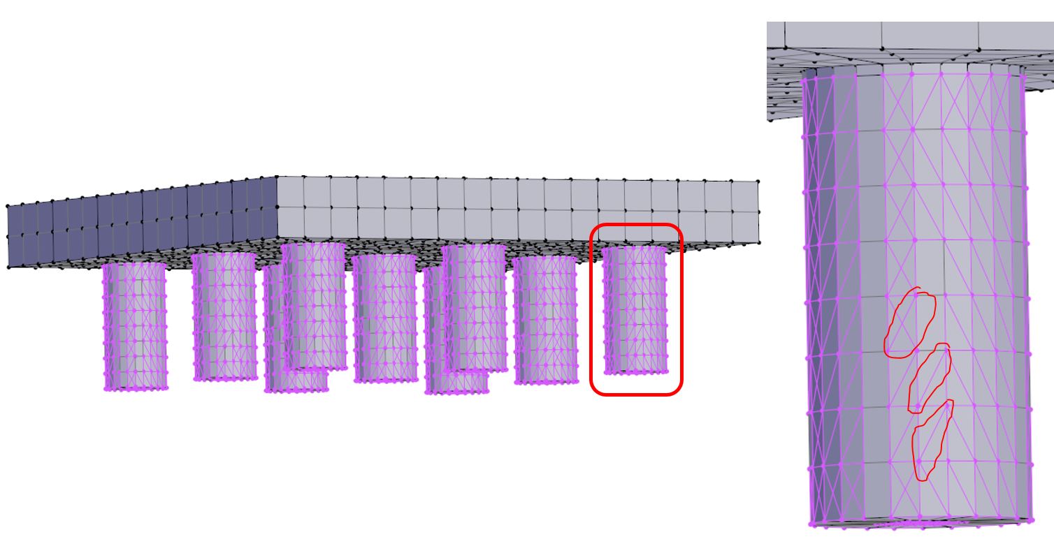

Thank you for your response. I have ran the model with the group of piles and the piles do not penetrate the soil anymore, so that issue is fixed. However, the overall stiffness of the systems seems smaller than expected. Upon in-depth investigation, it was observed that interactions are not connected as one would expect. Despite the fact that the locations of nodes of the pile elements and soil domain coincide, it appears that interactions are not generated between the closest nodes (see circled interactions in the screenshot below for more details). I would expect that these would show as dots, not lines. Can you please let me know how can this be fixed? The file attached in your response is the most recent one - i just increased the number of elements in vertical direction.
Please let me know. Thank you

Posted: Thu Mar 21, 2024 8:51 am
That's not the issue. It's just a visual representation of the node-to-element interaction:
For each slave node, STKO searches for the sub-triangle of each quad face it touches. Then it creates a visual representation of 1 line for each of the 3 masters (of the sub-triangle master) connecting them to the slave node.
If the stiffness is not as expected try to play with the contact parameters.
Also, try to make use contact also at the bottom face of the pile cap, probably its friction with the soil can play a role
