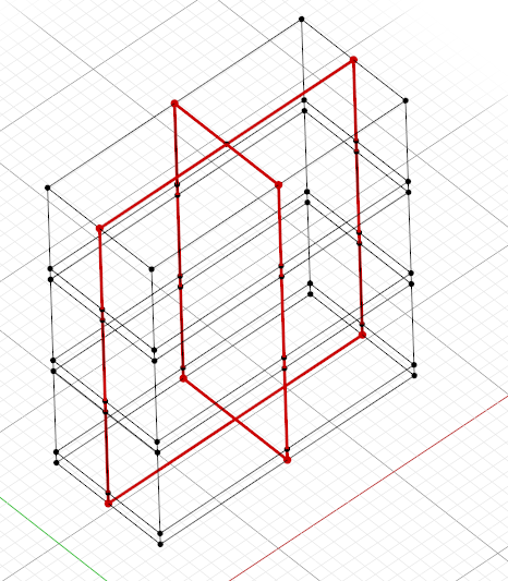

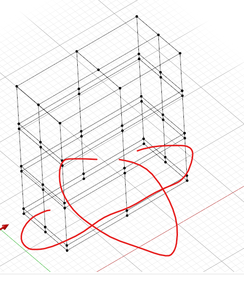

Re: Invalid type of elements or number of nodes

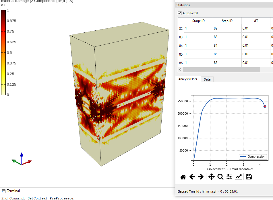

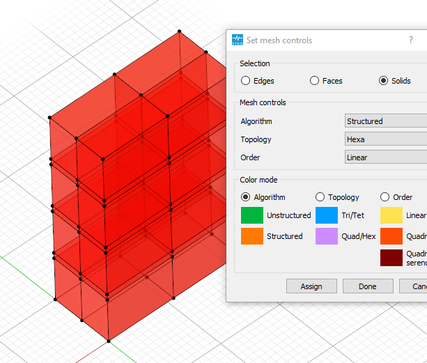

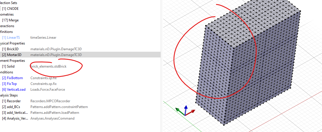

There were some issues in your model:
Finally I applied an imposed displacement on top (with load control) instead of a force (with disp control) because with the force only, if the damage will be unsymmetric, the prism will rotate.
Here's what I get:
- The error you get comes from an incompatibility between the element property (brick = hexahedron) and the mesh type (tetrahedron). To mesh your model with hexa elements I had to add some internal cuts: merge everything and assign proper mesh controls
Here's what I get:

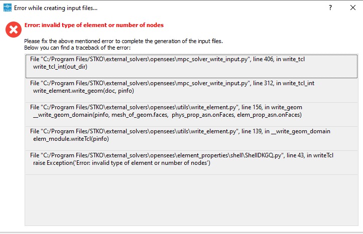

I also have the same problem with my model.
Could you please help me to detach the problem? I have attached the model.![Image]()
- Imagen de WhatsApp 2024-09-12 a las 17.05.40_dc9d103f.jpg (87.16 KiB) Viewed 1193 times
- confined.2.rar
- (125.83 KiB) Downloaded 104 times
You are using a Triangular mesh with a quadrilateral element (those are incompatible)
You either use a triangular mesh with a triangular element property (ShellDKGT, ASDShellT3)
or a quadrilateral mesh with a quadrilateral element property (ShellDKGQ, ASDShellQ4)

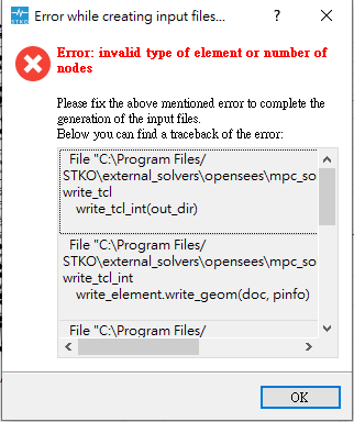

I also encountered the same problem.
I have checked the element properties that I assigned, it seemed to be right.
As for the geometry, I am not sure if there is something wrong.
Could you please help me to find the mistakes I made?
There are the error screenshot and my model file below.
Thank you very much!
- modal analysis.rar
- (458.52 KiB) Downloaded 88 times
- 擷取.PNG (15.01 KiB) Viewed 1049 times
Same error!
You are using the ShellMITC4 element on a triangular mesh.
You either make the mesh all-quad, or use the ASDShellT3 element

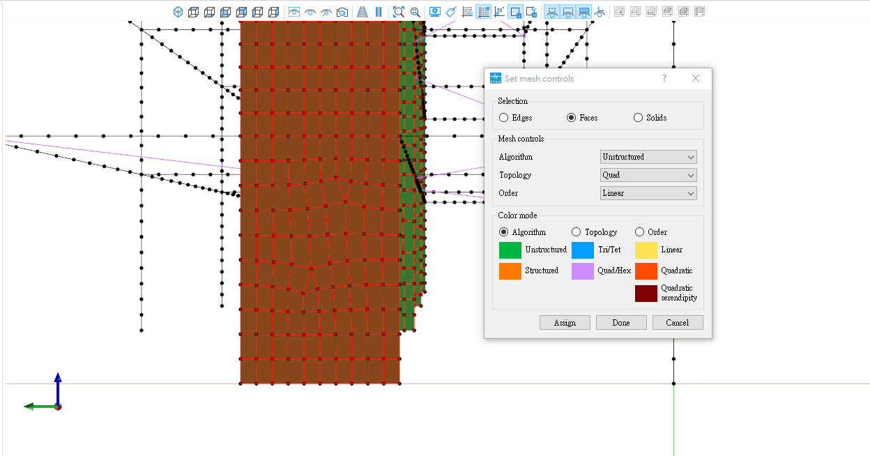

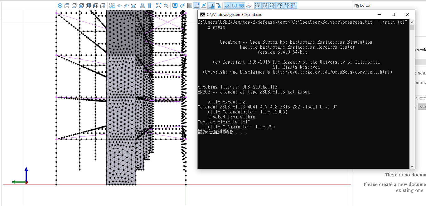

Thank you very much for your prompt response!
Following your suggestions, I have attempted to adjust the seeds and set the element to rebuild a quad mesh.
However, despite these efforts, the elements still appear as triangular meshes (as shown in Figure 1), and I am unsure how to resolve this issue.
Additionally, I also tried using the ASDShellT3 element with triangular mesh, but I encountered an error when running the analysis (as shown in Figure 2).
I have attached the model file for your reference. I would greatly appreciate your assistance in resolving this matter.
Thank you very much for your time and support. I look forward to your response.
- 擷取.PNG (77.94 KiB) Viewed 986 times
- 1.PNG (154.56 KiB) Viewed 986 times
- meshing problem.rar
- (609.5 KiB) Downloaded 86 times
An all-quad mesh is guaranteed only if you have 4-sided surfaces (which is not your case).
Use the ASDShellT3, but make sure to use the latest opensees (3.7.0) (we added it recently):
https://www.researchgate.net/publicatio ... r_OpenSees
