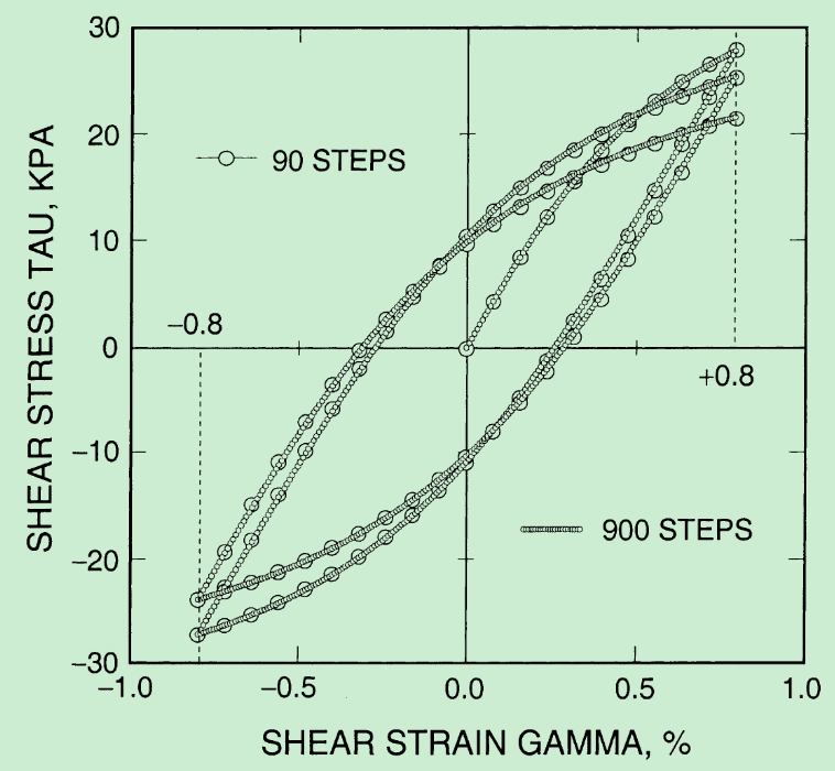

Thanks, reducing the self-weight and using adaptive steps really make sense.
But, why does no plastic deformation occur under confined compression?
Moreover, the shear cycle cannot be completed at 75kpa compression as the paper shows.

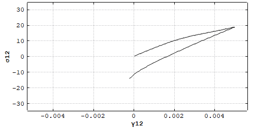

I don't understand what you are trying to do in this example, however
1) you can see plastic deformation in your cycle (when sigma_12 unloads to zero the deformation is not zero).
2) Then you material fails in the 3rd stage where you are removing (?) the vertical compression (probably it makes sense, it cannot bear anymore those shear values?)

In fact, the shear behavior in my third shear stage consists of four pushover processes. However, the model fails to converge at the beginning of the third pushover stage, and it has not yet progressed to the fourth stage of unloading. Why can't I complete the entire shear process as described in the article? The shear stress level at failure has not yet reached its historical maximum.
