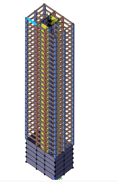

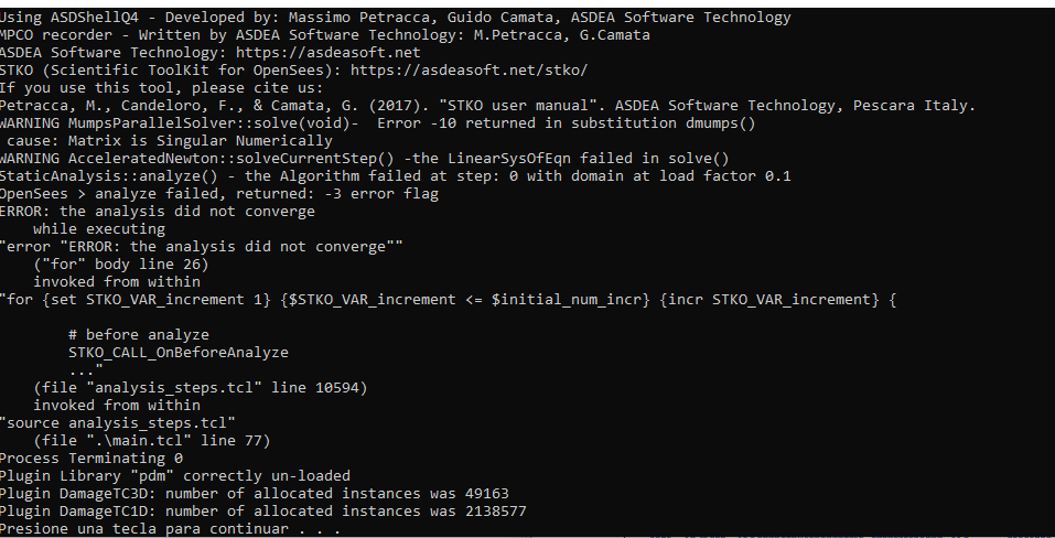

Now I modeled the whole structure of my research but I get this problem, please your help.
error edificio grande.png (52.59 KiB) Viewed 5027 times
model complete.png (163.38 KiB) Viewed 5027 times
Re: MOMENTS AND SHEARS IN SHEAR WALL
Post by STKO Team » Wed Nov 23, 2022 8:57 am
The error message is saying that the model is singular.
But without the SCD model, I cannot tell you the reason for it. Can you share it?

I could to solve that problem. But I had another problem Please whats the meaning about this mistake? Because the model continued running.
And how to get the moment-curvature of the shear walls thans a lot for your answers.
Best regards.
PD I´ve attached the new mistake and the model (please. once you download it could you erase it?)
new mistake.png (63.61 KiB) Viewed 5011 times
Post by STKO Team » Mon Nov 28, 2022 7:59 am
You're welcome!
It's not a problem. It says that OpenSees had a convergence issue. Then the analysis loop written by STKO tries to reduce the time-step to allow convergence (it's because you chose Adaptive Time Step).
