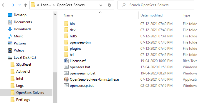

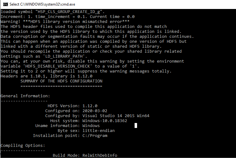

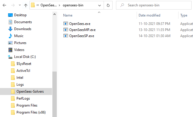

Even after installing the latest version of OpenSees solvers from Prof. Tarque's website, I am getting the same error again. I am unable to use STKO.
Please refer to the images below.
- c.PNG (30.53 KiB) Viewed 1685 times
- b.PNG (22 KiB) Viewed 1685 times
- a.PNG (33.24 KiB) Viewed 1685 times
Re: hdf5.dll
If you downloaded the latest version this should not happen, because the OpenSees.exe is using the same HDF5 DLL version (1.12.0) found in the hdf5 folder.
Your error is saying that your OpenSees is linked to the 1.10.1 version (old version) while the DLLs in the hdf5 directory are 1.12.0.
Probably you are running another OpenSees.exe.
Could you show me the solver you are using in the Window that pops-up when you click on the "Kits" command?
