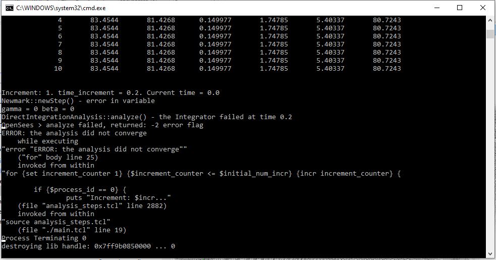

Post by felicegiordano95 » Mon Aug 30, 2021 2:10 pm
Thank you very much for your continued support, unfortunately even with the suggested changes the model fails to converge and I don't understand if it's a modeling or analysis setup problem.

Posts: 363
Re: Model with viscous connections
Post by marafini.f » Mon Aug 30, 2021 4:00 pm
Try this

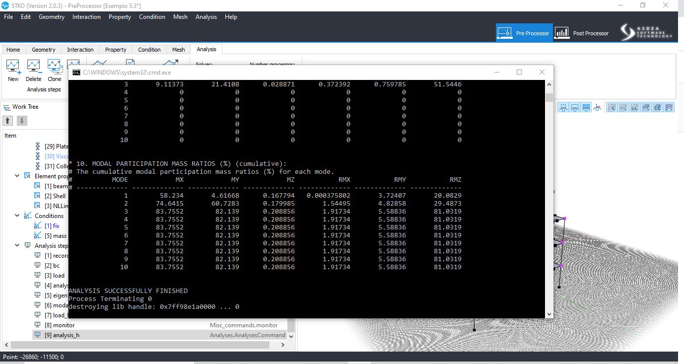

Post by felicegiordano95 » Thu Sep 09, 2021 10:16 pm
Unfortunately, the analysis does not give consistent results, I have greatly simplified the model and I am attaching it, unfortunately the modal analysis reports outsized values although we have greatly simplified the model, I cannot identify the error. thanks again for the support.

Posts: 363
Post by marafini.f » Fri Sep 10, 2021 9:54 am
If the results are not in the right order of magnitude it means units are not correct.
Did you check your units? Everything needs to be in the same unit system.
Did you check the webinars we have done on eigenvalue analysis? Open the support files, they are on the website. Analysis set up is explained there for eigenvalue analysis.
