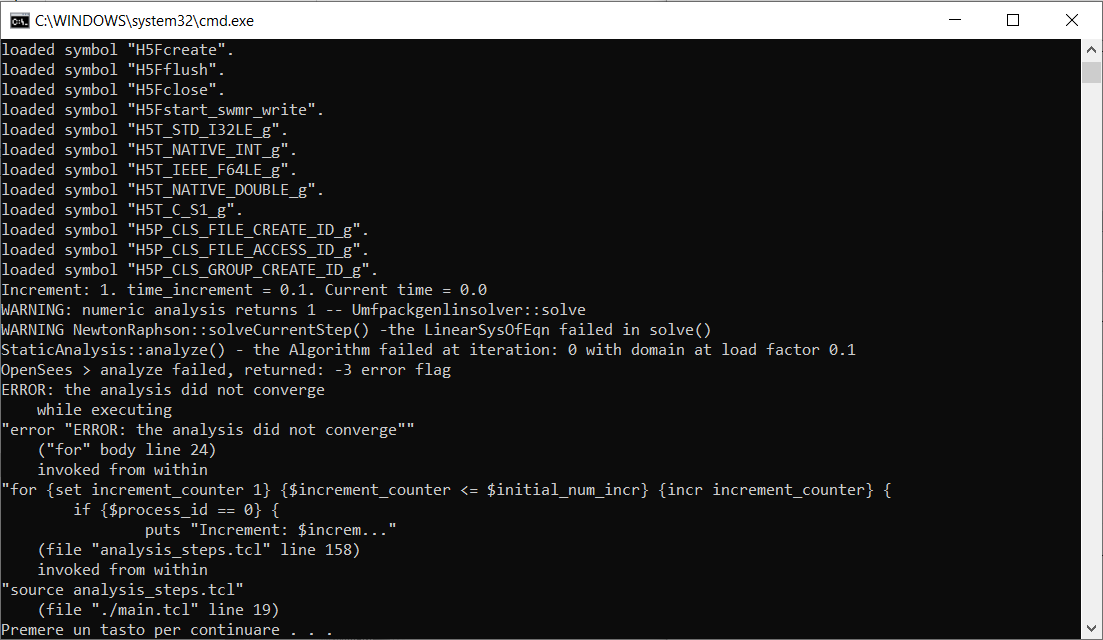

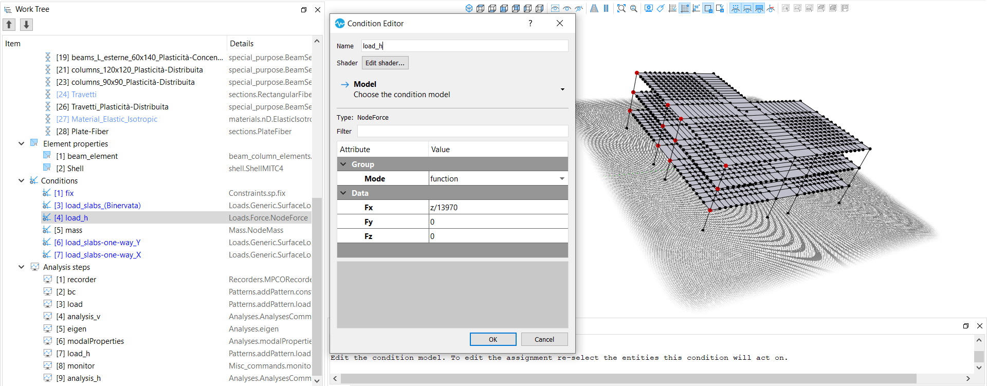

I entered the horizontal load in the following way, but nevertheless it generates an error during the analysis.
Therefore, I am sending you the inherent file.

Re: Pushover analysis error
I've just seen your model,
it is singular because your second geometry (travetti) is detached from the other.
One more question, you are using the SurfaceLoad utility on a shell which is physically modelled... If you model the slab then you need to use the FaceForce, while the SurfaceLoad is applied on a geometric surface when you don't want to model the slab.
What approach do you want to use?
Dear user,
here is your model which is working fine now There were still few errors that we fixed:
- travetti and main-structure geometries should be merged
- I had to add a few more construction lines in the merge operations to guarantee a quad mesh
- Master node geometries should be removed, because you don't have rigidDiaphragms, so those nodes will be unconstrained
- I added a other constructions lines in the slabs such that their interactions generate a vertex at the center of each floor, where the master nodes were. Just to use it as a monitor for top displacement.
- beams had a hinge-integration scheme, but now that they are merged with the slab, and therefore meshed, that integration rule is not applicable anymore, so I converted them into distributed (Lobatto) rule with 3 points each one.
