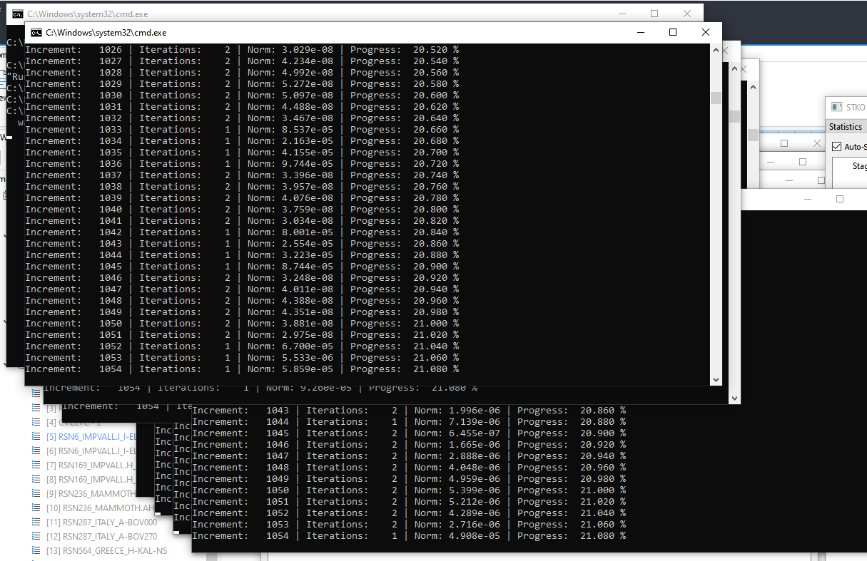

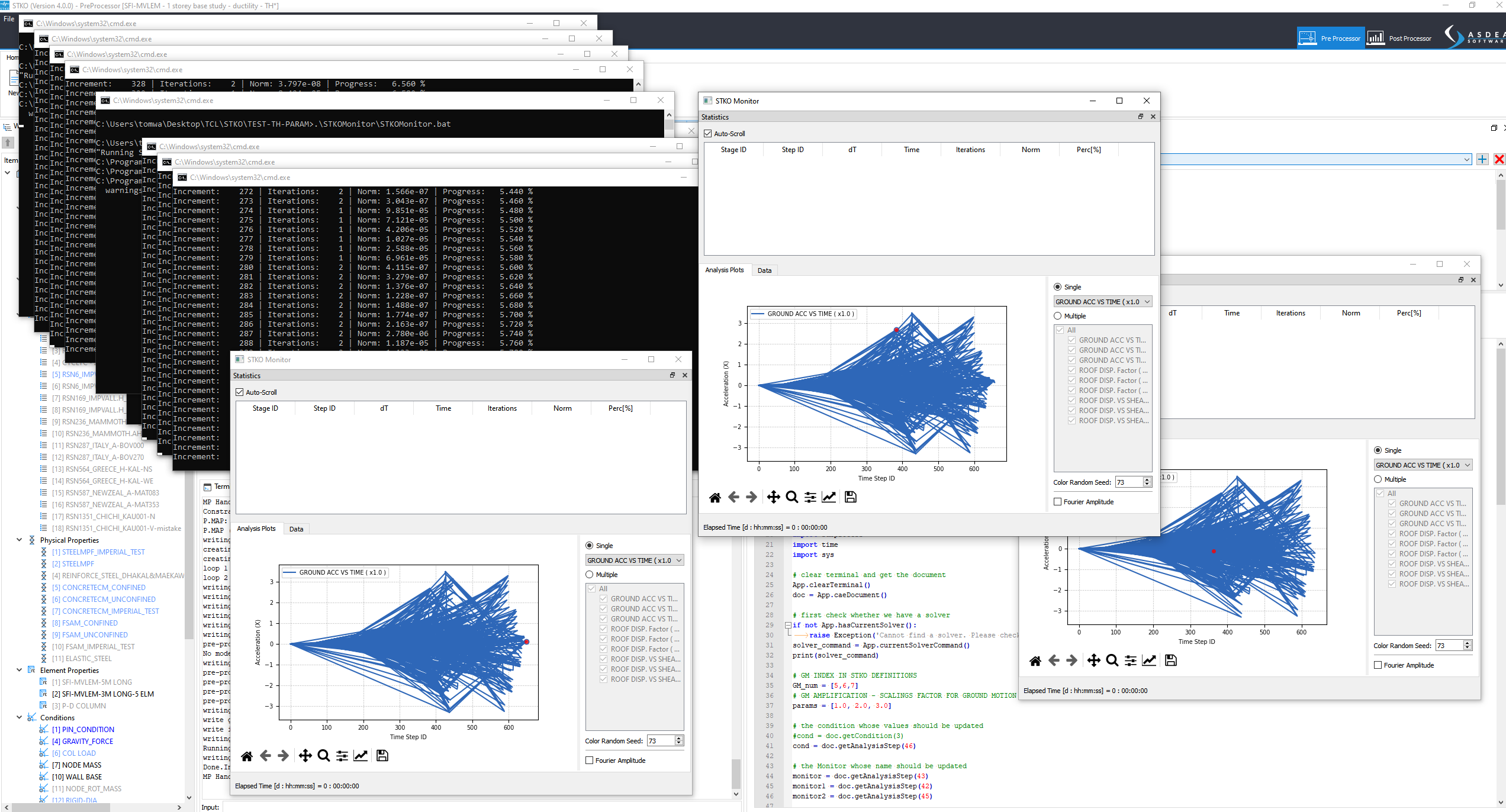

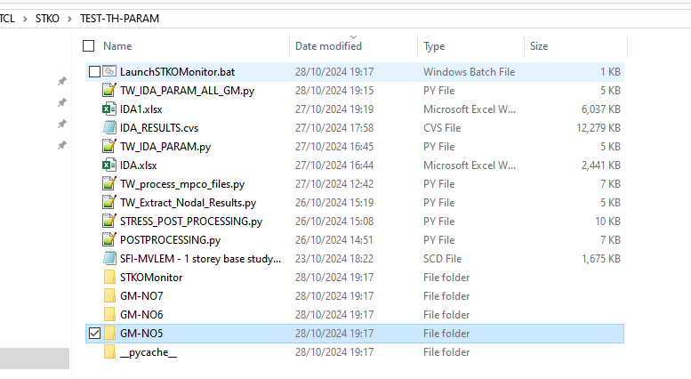

Now I have implemented (looping through)different GMs on top of the intensity. The python code I edited from STKO example properly create sub folders for different intensities for a given GM, but 3 monitor pop ups show completely meaning less movement. It looks like these analyses are mixed up in the monitor. It also looks like the analysis was performed for the first GM index only. The TCL files appear to have generated correctly.

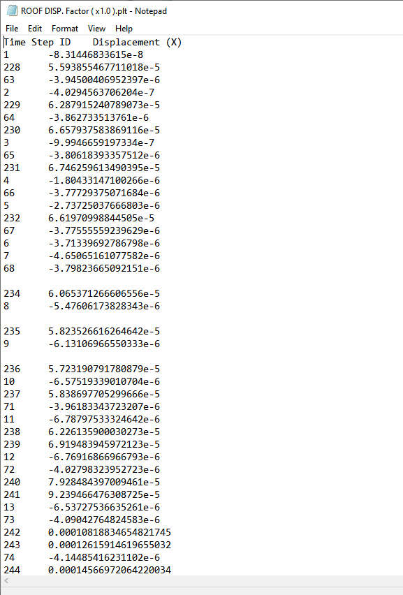

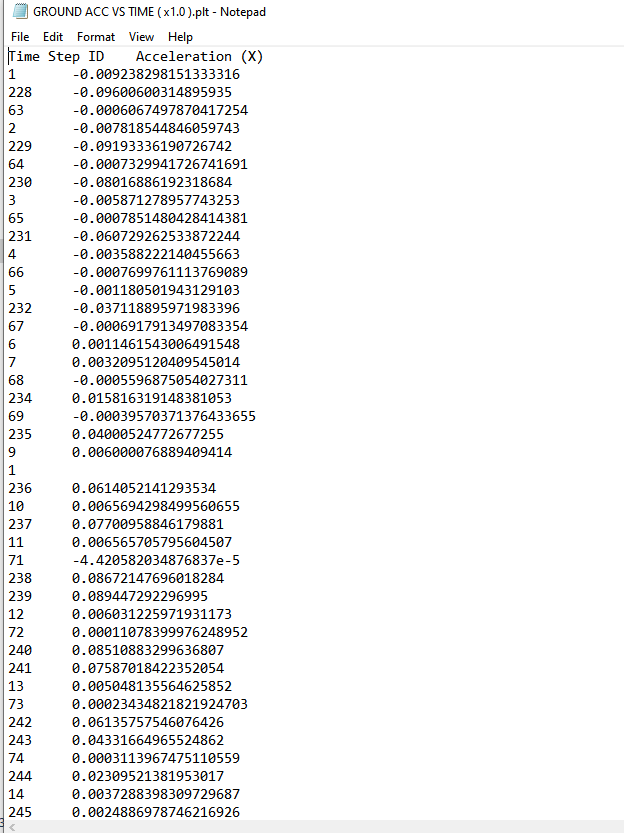

Upon inspection of the PLT files, the out put is completely stuffed up with gaps etc as per below snip.
I want to have one monitor each ( with roof disp history, shear vs disp and acceleration) for a given GM. so in this instance, 3 monitors each showing one GM case with different intensities much the same as when I had one GM and different intensities.
The other thing I noticed is that all analyses appear to stop at 21% without any warning. I am sure the file works as I have been verifying the parameters etc.

It seems that you are using incorrectly the multiple processors. I see 3 subdirs for 3 gms but I see more opensees windows
