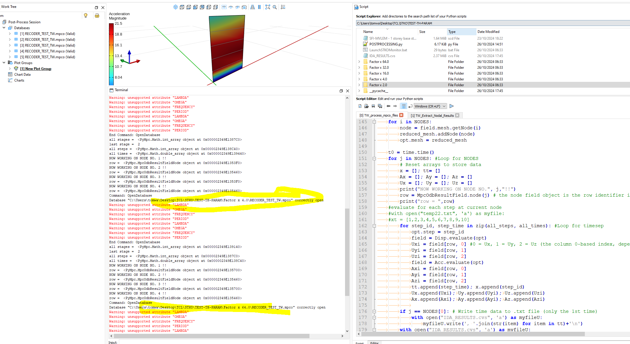

I am facing a problem with extracting nodal acceleration and displacement from multiple MPCO files.
I found some great examples from your team to extract nodal response from MPCO using python API and looping through between multiple MPCO files. So, I sort of combined the two examples.

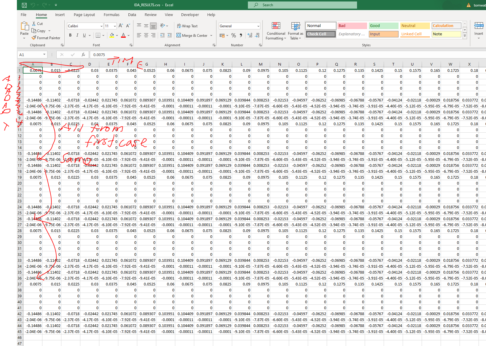

As you can see from below image, all 5 MPCO files appear to be opened correctly in the terminal, but the CVS results are repeating. Upon detailed check with *.PLT files from monitoring, only the first MPCO file was extracted & the rest are repeating.
I have attached file. Can someone please have a look at it and recommend correction ? I am sure it will be simple syntax issue. I played around with it but could not figure it out myself.

Sorry guys, I found a mistake in the code, looping between Multiple MPCO files is now sorted.
