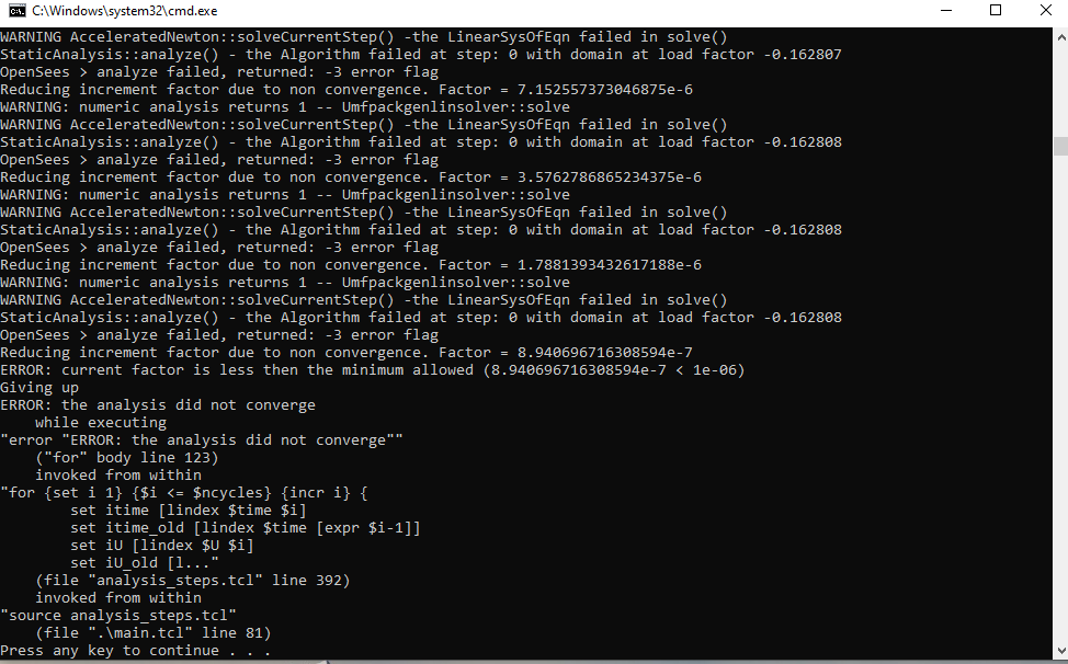

I still got some issues with convergency for both push over static and time history. For the static push over case, it was working fine when I had only single Storey walls but when I developed into multi-Storey structure, static does not converge (stop @ around 47% in). Could someone in STKO please have a look at the attached files and make some recommendations in relating to how to handle the convergency issues. Your input will be much appreciated.
Capture error mesage.PNG (58.95 KiB) Viewed 380 times

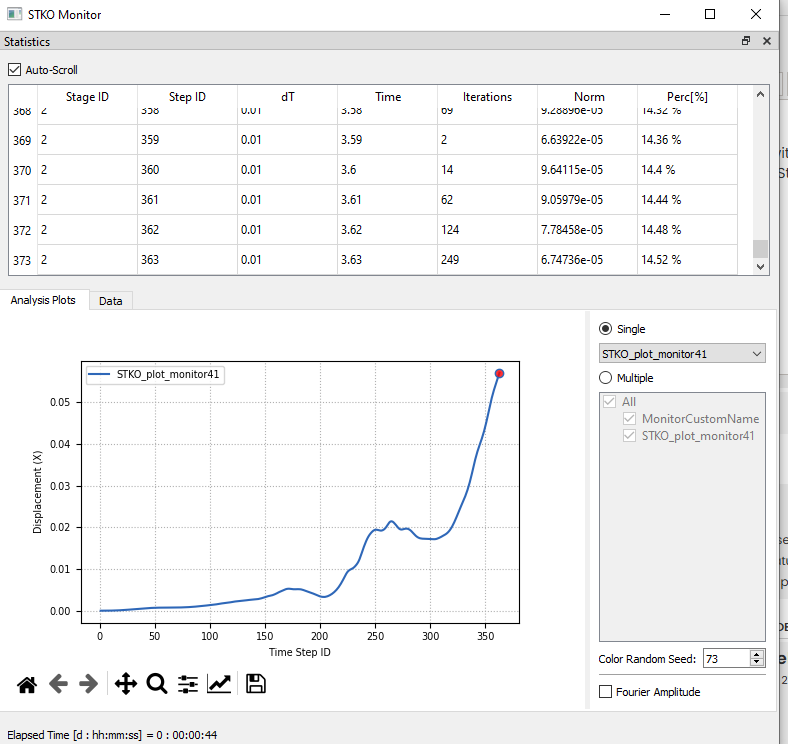

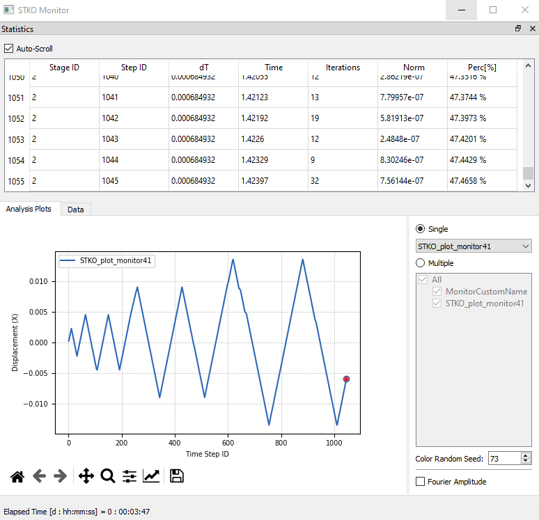

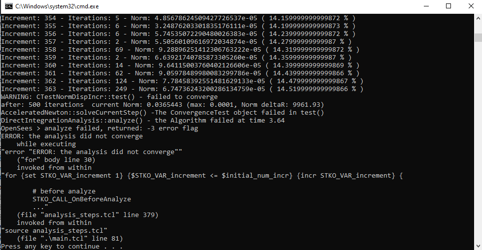

Time history results are as below. The global displacement appears to keep increasing and not oscillating right from the start. Damping would be suspicious, but I have auto Layleigh specifying first and second frequencies, so it can not go wrong in my view.
Capture th failure messag.PNG (47.89 KiB) Viewed 380 times

The concrete and steel models may have some congerence issues.
Try to handle them by using a smaller initial time step (like 5000).
Regarding the dynamic analysis, can you check what happens if you make the damping proportional to the initial stiffness rather than the tangent stiffness.
