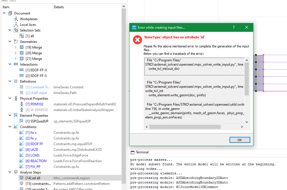

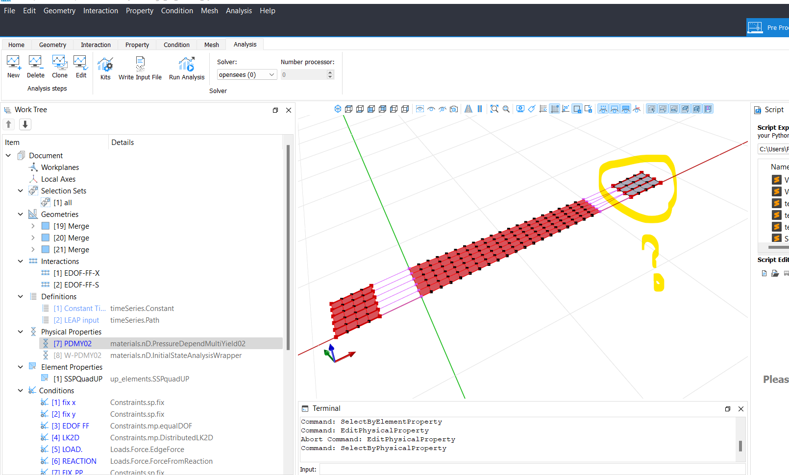

Hi STKO Team. My model doesn't run because of this error. I checked the geometry but the issue is not clear to me.
Can you please check the model and look what is going wrong? (I'm modelling a Soil Slope)

Hi, the error says that the SSPquadUP element is missing physical property assignment! Please check the attached figure and ensure you apply appropriate physical properties for all the elements before running the analysis. You can also look at the last line of the error message to understand where the error originates from.
