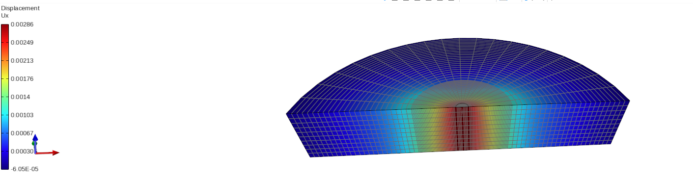

I'm currently conducting a simulation where I laterally move a pile (only in the x-direction) in a sinusoidal prescribed pattern. In the initial analysis, I used a prescribed load and obtained the predicted displacement of the pile.
For the next analysis, I prescribed a displacement (obtained from the previous analysis) on the node rather than a prescribed load. I want to measure the amount of force required to move the pile by this displacement (ux). Additionally, I'm interested in tracking the development of the force Fx when the pile moves in a sinusoidal pattern.
Could someone please advise me on how to proceed with this ? What types of recorders would I need to collect the necessary data?
FYI, the prescribed load and displacement are given on one node in the pile region, with the rest of the nodes in the pile region tied to this master node.
Attached below is a screenshot of the model at the peak of the sinusoidal displacement.
Thank you in advance for your assistance.

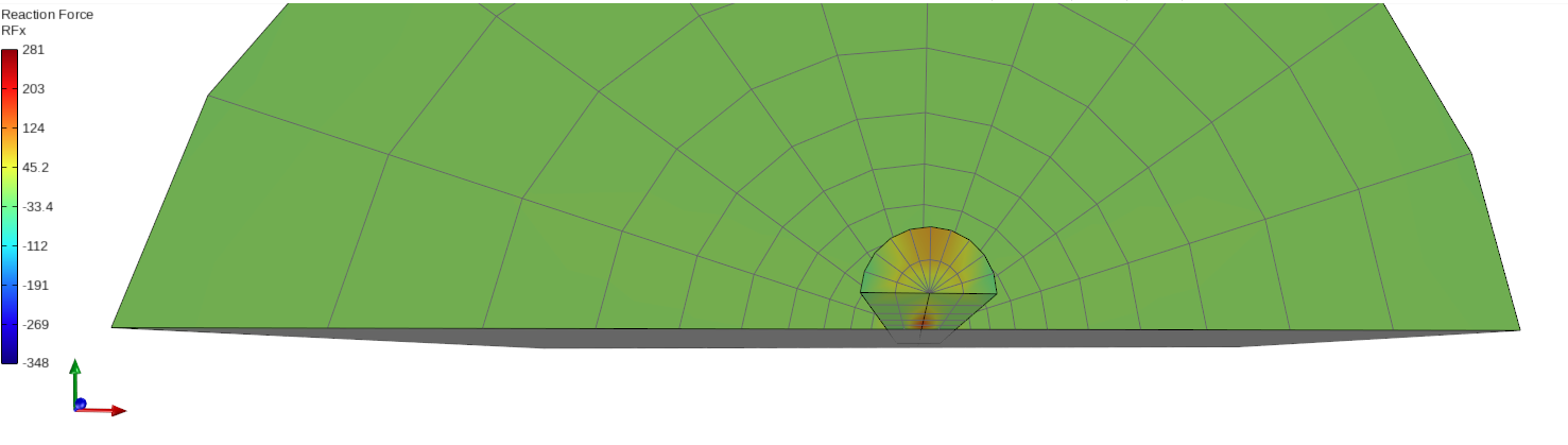

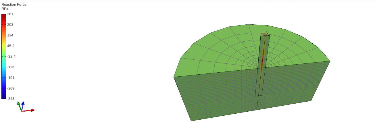

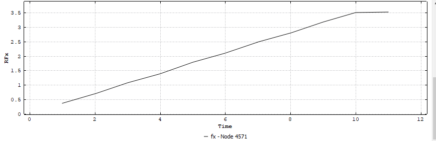

Next, I started a new analysis, where I applied a prescribed load using the sp command of ux =0.0033m at the master node. I used the suggested methods (above) to monitor and record the reaction forces of that master node, hoping to get a reaction (RFx) of 1MN. But i only got a monitored value of 3.518kN. Below are some screen shots to help with he visualisation (master node 4571).

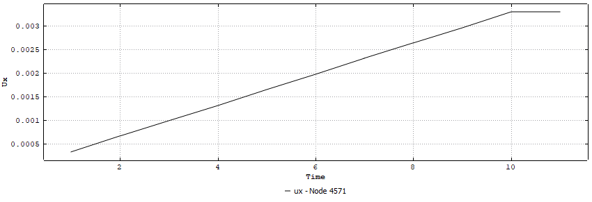

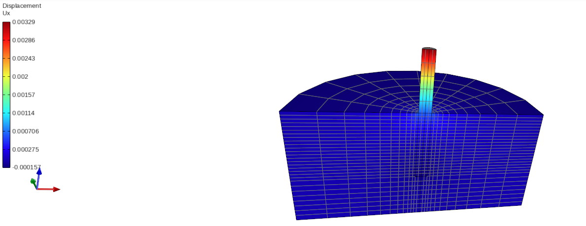

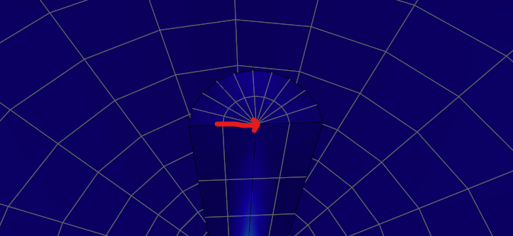

I am still unable to obtain the results i want. This query applies to a new scenario, I have a wished in place pile in a soil body, with the top of the pile subjected to a load of H0=1MN in X direction. At the centre of the pile are multiple nodes with close to 0 coordinates, and I have tied them all together in the XYZ direction with equalDOF command to represent the centre of the model (this is done throughout the z direction of the pile and the soil body). Additionally, I have tied all the nodes at the top surface of the pile to the master node (which i apply my load on) in the x direction. I initally applied a the load H0 for a transient analysis of 11s (increasing load with time). After which i have obtained a final ux displacement at the master node of 0.0033m.

Re: RE; Recording Fx due to displacement Ux
Why did you create several nodes overlapping?
When you attach them (slaves) to a master (on which you apply the imposed constraint) the reactions go on the slaves!
That's why you don't see the full reaction
