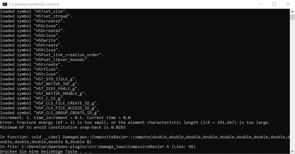

I am trying to analyze this model related to this Youtube video.
[https://www.youtube.com/watch?v=vPB9ZwT ... 7qTOJL94rv ]
& I got this error in the photo.
Can you please explain to me why i get this message.
Thank you very much for the support!!

Error message by the analysis
- Error massage.jpg (132.5 KiB) Viewed 629 times

Re: Error message by the analysis
Hi, One of the reasons for the error is overly coarse mesh in your model. If you look the following research article (pg.11, Eq.30) on DamageTC3D model, there is condition to check the snap-back behaviour of the constitutive model, which is:
Research article:
Petracca, Massimo, Luca Pelà, Riccardo Rossi, Stefano Zaghi, Guido Camata, and Enrico Spacone. "Micro-scale continuous and discrete numerical models for nonlinear analysis of masonry shear walls." Construction and Building Materials 149 (2017): 296-314.
l_dis is calculated from the mesh size (min edge size in quad element). So, there will an error if the condition is violated. I reduced the global mesh size to 100 in your model, it now works fine. Attached is the modified model.l_dis < 2Gc/(sigma_p x epsilon_p)
Research article:
