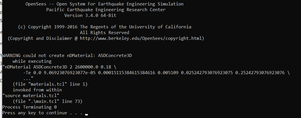

I have a problem when I want to run my model with ASDConcrete3D physical property. I get an error that the nDMaterial cannot be created (see figure). It is possible to run the model with an elastic isotropic nD material, so I think it is not a problem of the geometry. I also tried running the "mestyanek_shear_wall_coarse_implex" model from webinar #32 and got the same kind of error. Is there a parameter that I have wrongly assigned or is there something missing that causes this error?

Error: Could not create nDMaterial ASDConcrete3D

Re: Error: Could not create nDMaterial ASDConcrete3D
Hi, you should use the recent version of OpenSees (your screenshot shows an older version. v3.4). I use version 3.5.1, I do not face such issue. You can check with the link below for a precompiled OpenSees version or the official OpenSees site.

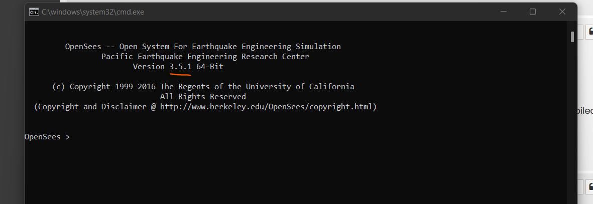

Hi, I downloaded the OpenSees solvers from Prof. Nicola Tarque's researchgate website. Though it mentions version 3.4.0 in the site, I could see version 3.5.1 when I actually installed it on my computer. So, you can try it.
