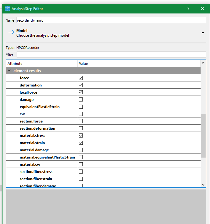

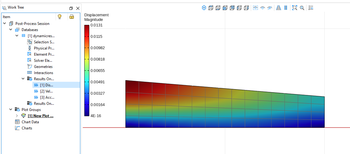

I am modeling a centrifugal test. After performing the static and dynamic analysis of the model and going to the post process I get results in the nodes but not in the elements.
What is the cause of this and how can I fix it?

Anyway I think you are using reduced-integration elements. If this is the case, in the recorder choose strain and stress instead of material.strain and material.stress (you can do it in the custom element results)
