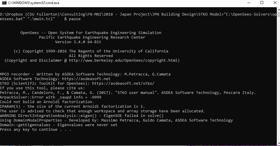

I am trying to perform modal analysis of a frame building. The model has rigid diaphragms and lumped masses at each floor. When I try to run modal analysis and get the following error.
I am not sure what is the issue. I ran modal analyses before with the same computer and STKO and didnt have issue. Can you please let me know how to overcome this? The model is attached for your convenience.

You are using Timoshenko beams, which require the shear areas (Ay = Area*alphaY and Az = Area*alphaZ), but in all your custom sections the alpha values (shear correction factors) are 0. So the shear areas are zero and the shear stiffness is zero, making the element singular, thus the Arpack error.
Here you have your model were I set all shear factors to 5/6, the typical values for rectangular cross-sections with typical aspect ratios. You may want to adjust those shear factor depending on the shape of your beams/columns

Ah, of course, that makes sense. I was wondering where do you define this. I guess I got used to see this parameter being called "k" and didn't catch it. Thank you for fixing it, there was a lot of sections to change. If possible, it would be useful to add description of the section parameters (similarly to other parameters in the model) in future versions.
