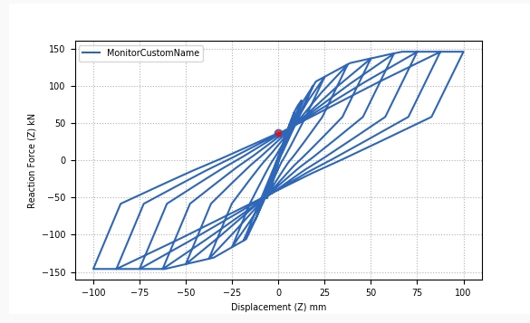

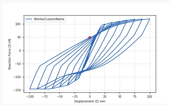

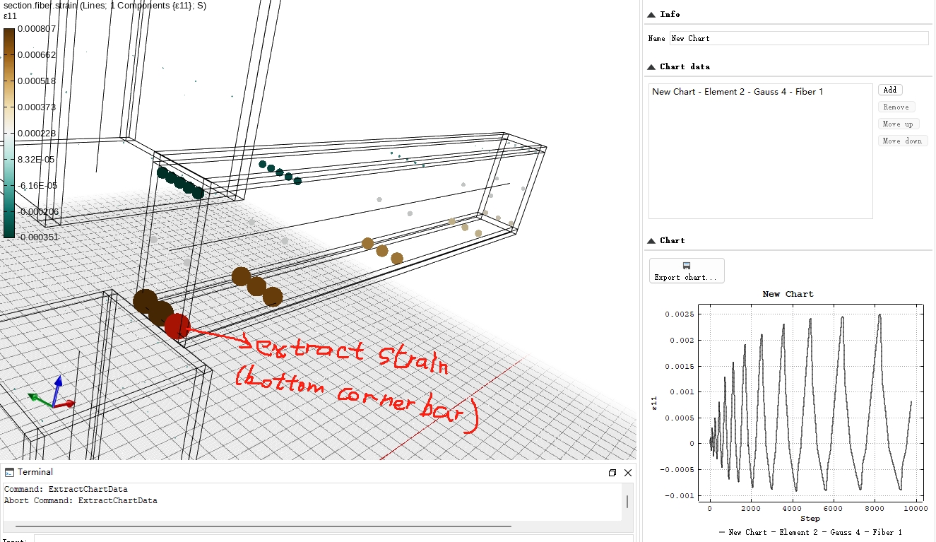

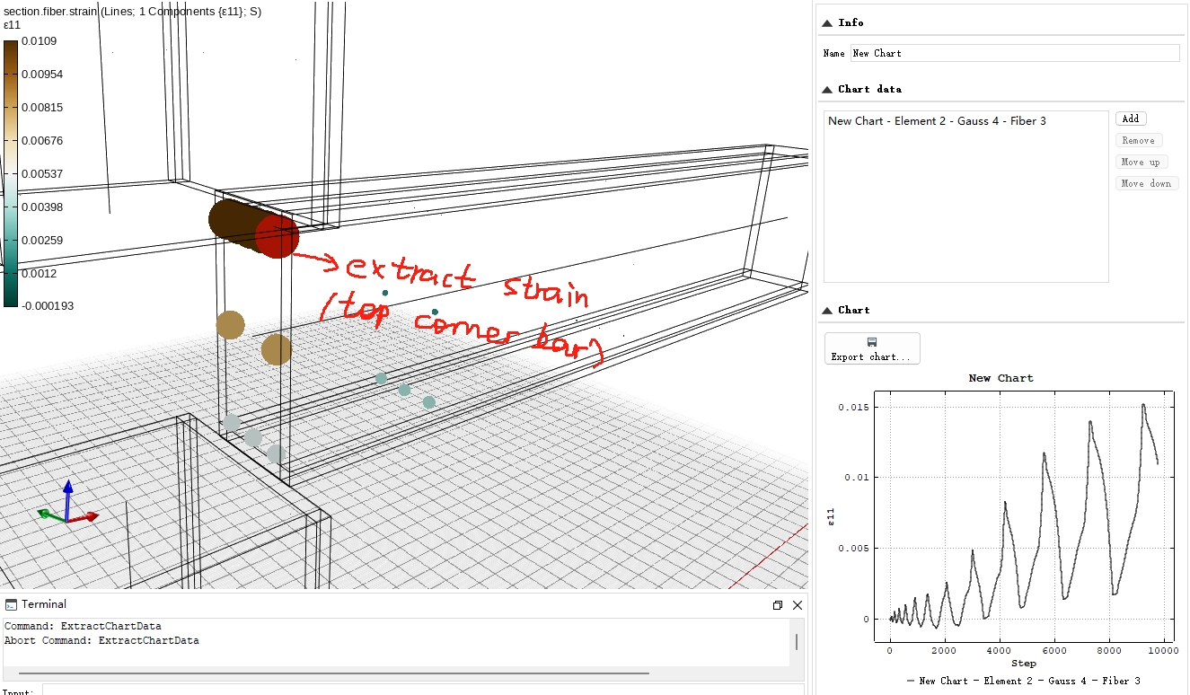

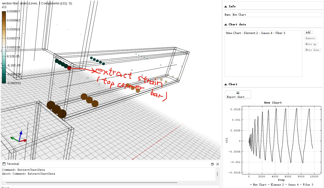

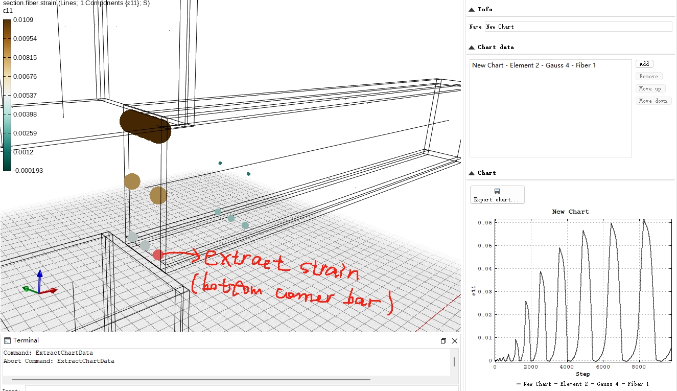

I have built a simple joint model containing pinching4 material, I did hysteretic analysis using dispBeamColumn element and forceBeamColumn element respectively. The other parameters are same, but the hysteresis curves and fiber strain are very different. What is the reason for the difference? I am curious which result is correct.

- bottom strain using force elem.jpg (427.29 KiB) Viewed 995 times
- bottom strain using dip elem.jpg (447.32 KiB) Viewed 995 times
- top strain using force ele.jpg (416.71 KiB) Viewed 995 times
- top strain using disp ele.jpg (452.84 KiB) Viewed 995 times
- hyst curve using force elem.jpg (93.22 KiB) Viewed 995 times
- hyst curve using disp elem.jpg (90.68 KiB) Viewed 995 times

Short answer:
Force-based element is more accurate. Disp-based -> you need more elements per structural member.
Long answer:
Since you are using pinching 4 with softening, you have to pay attention to mesh-objectivity with respect to the amount of dissipated energy.
