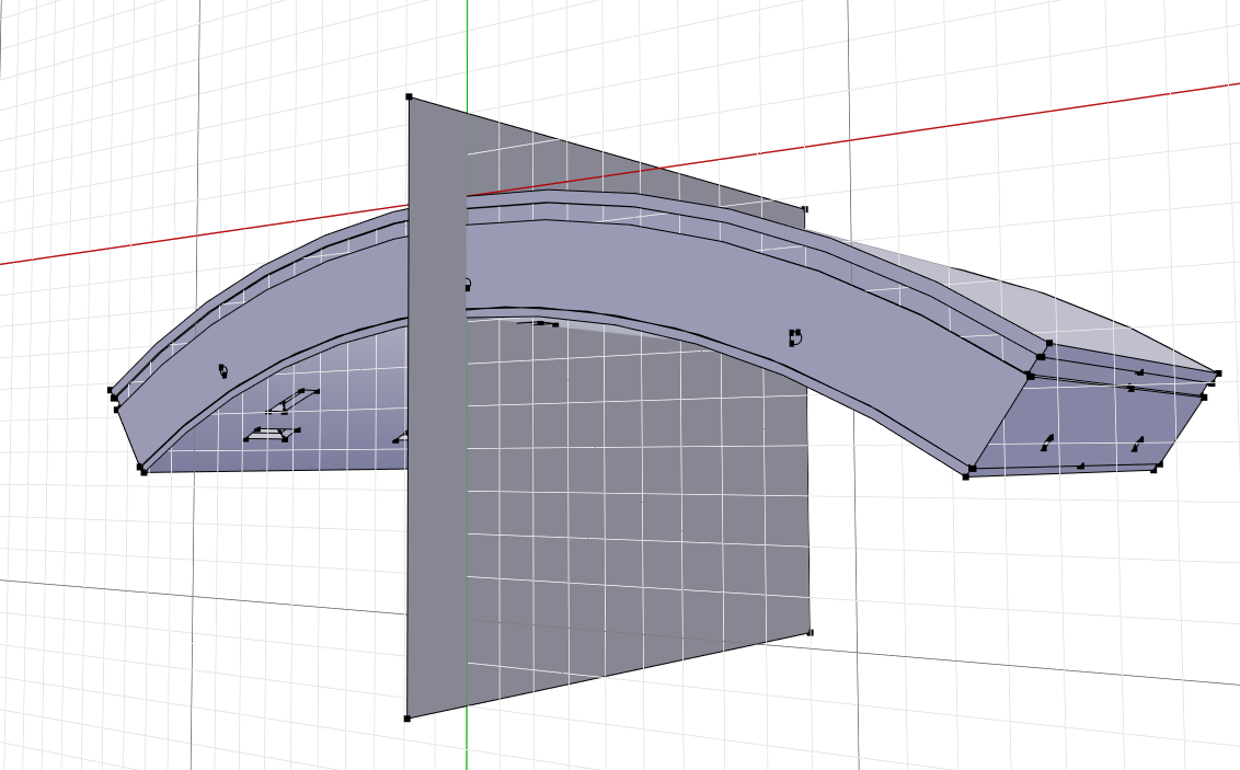

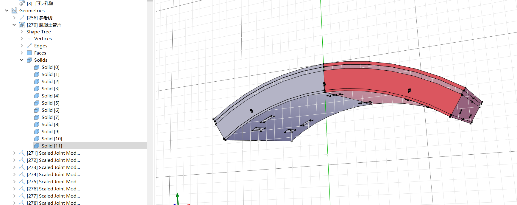

Re: Boolean operations
Certainly!
I've imported a 3D segment model and utilized a plane to execute a cut using operations like 'Merge' and 'Explode', similar to what's depicted in Figure 1.
Now, my objective is to modify the right segment independently. However, despite the explosion, each part remains grouped within the 'Merge' operation, hindering individual manipulation as seen in Figure 2.
Repeat the explode command on that geometry. The explode command may be used multiple times in nested loops

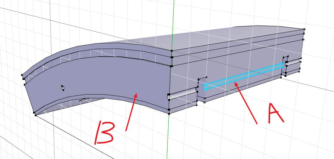

Thanks for your reply!
For example, I hope to union the A and B without a public surface.
However, whether I use 'union' or 'merge', there is still a public surface.
Is there any way to solve it?
Thanks!
I still have this question.
Thanks!
Hi, You can handle the individual geometry after the explode command executed multiple times. So, the extra surfaces can be deleted.
Just a suggestion for the first issue that you pointed out, why don't you make two copies (say 1 and 2) of the solid+plane geometry in the same workspace and do the merge for both and then use subselection for geometry to delete the right part after the plane for 1 copy and delete the left part before the plane for 2 copy. Doing so, you will have two separate geometries, you can bring them together at a common vertex.
