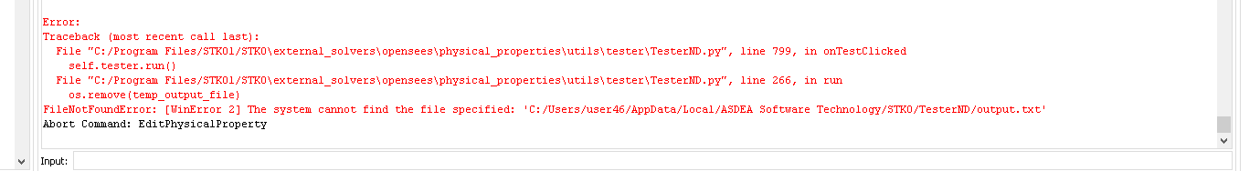

I’d like to test the ASDConcrete3D material model for a numerical calibration of a cyclic test we performed at the University of Minho. However, the material test tool does not work and reports me an error message (see attached).
Could you please help me to fix it?

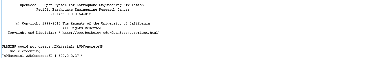

That is only the last part of the error message. Could you please scroll up until you see the the OpenSees output? Could you copy-paste that here?
Re: ASDConcrete3D material model - Material test not working
Hi, is this fine? Thank you for the support
- ASDConcrete3D_Error_1.png (7.15 KiB) Viewed 8064 times
It's because you are using an old OpenSees version without the ASDConcrete3D.
Please make sure you are using the lates STKO release and the latest OpenSees-Solvers (download the unofficial version from prof. Tarque's website as the current official version of OpenSees still has to be recompiled with this material)
Now, it's fixed. Thank you very much for the support.

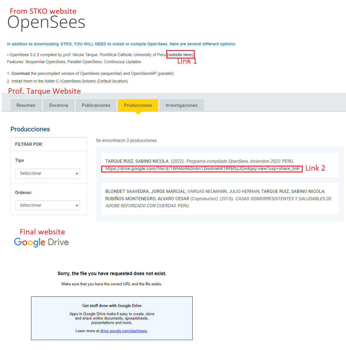

I wanted to ask if the link has been updated? I checked the link once again of Fri Jan 05 and still could not find the files. I attached the links I am using and the screenshot of the corresponding website.
Thank you for your help.
-- Links --
https://asdea.eu/software/system-requirements/
https://drive.google.com/file/d/1WHdo96 ... share_link
-- Links --
- img1.png (83.28 KiB) Viewed 6555 times

Hi, we checked with the Professor, the link is yet to be updated. We will resolve this issue as quickly as possible and update you here. Sorry for the incovenience caused.
