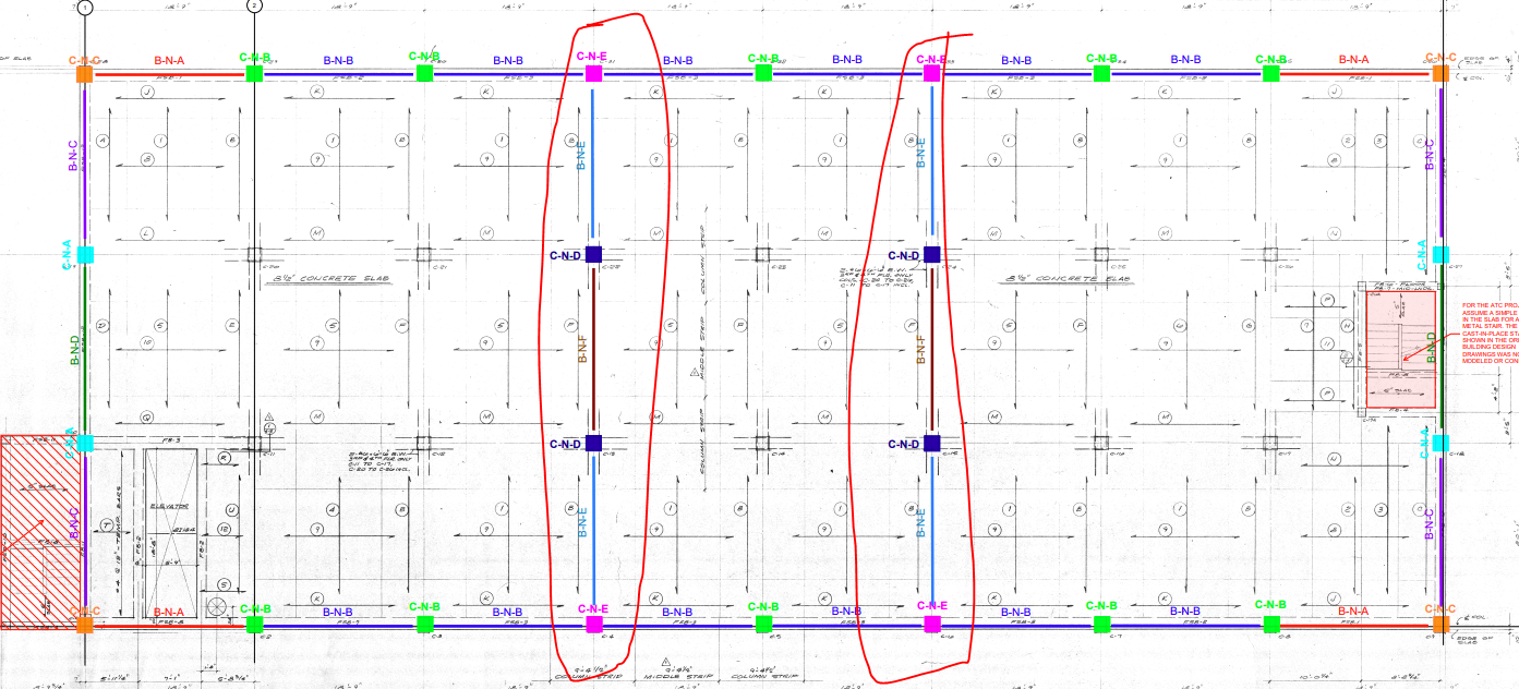

Yes, I can do that. The attached images is of the 1994 model. The additions in this model are the moment frames circled in red at gridlines 4 and 6.
The names of the added elements all correspond to C2D-C8D, C2E-C8E, B2E-B8E, and B2F-B8F. Each of these elements has an elastic section, ModIMK for the plastic hinge rotation, and a zero length material for the hinge, and finally a special purpose hinged beam to combine all in the physical model. For the new joints, I have added joints 29-35 for the new moment frames. The joints utilize pinching 4 to represent shear failure, and a special purpose beam-column element at the joints.

Hi, I don't see the attached figures in your previous post. Can you please check if they are uploaded?

My apologies, I will upload them here:
Please let me know if there is anything else I can help clarify
-Kate
