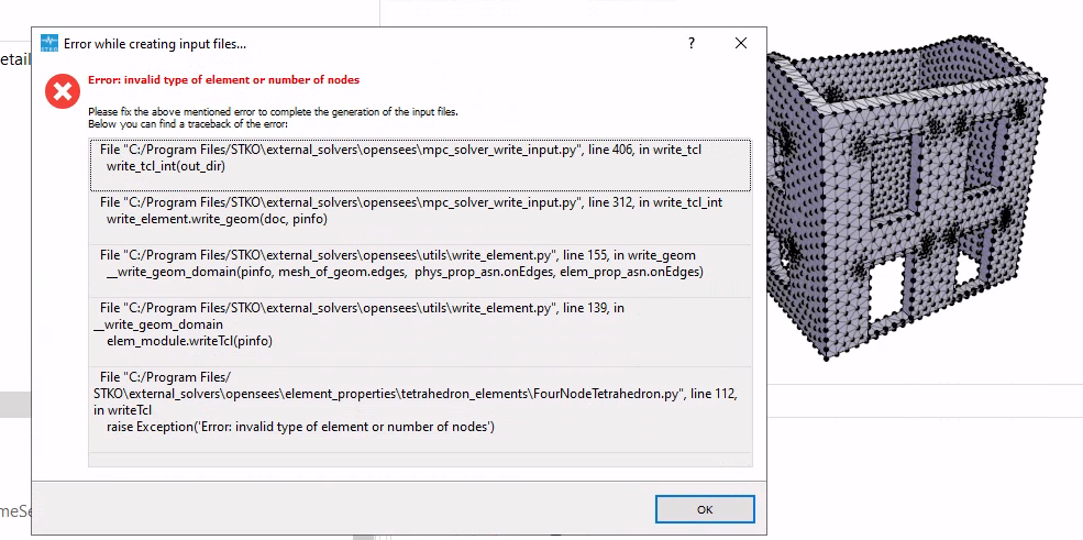

Hi, I was modeling a 4-wall URM building with timber lintels, using 4 nodes tetraedron. I am having issues every time that I try to run the analysis, no matter how I reach my final geometry.
I tried several types of CAD functions, even importing STEP files or doing it from scratch (performing different types of boolean operations). Could you please have a look at it? I am sending the file attached.
For this stage of modeling, please consider that I was planning to model everything as a perfect continuum, even though I am planning to use interface elements when I add the beams (maybe I will have some questions later on :D).
Thanks!
All the best,
Laura
21_11CompoundExploded.zip
(133.93 KiB) Downloaded 233 times
Screenshot 2023-11-21 195639.png (364.1 KiB) Viewed 1819 times

There were some mistakes:
  • The geometry is imprecise: the windows on the left are not exactly on the plane of the wall, creating small faces.
  • The solids must be merged together or linked with some interaction, otherwise, the model will be singular
  • The assignment is wrong. Materials and Element Properties are assigned to the boundary edges and not to the volumes
  • Masses and self-weight in volumForce conditions are wrong according to your unit system

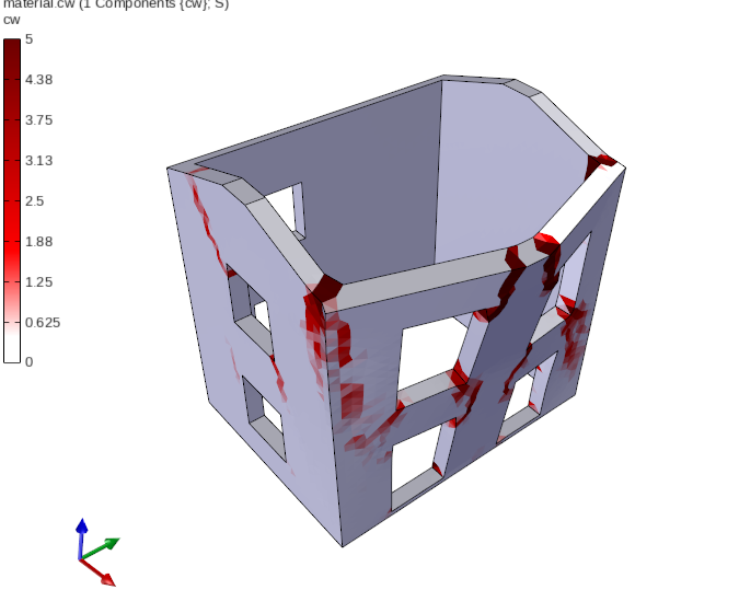

Check this file:
(1.46 MiB) Downloaded 221 times
Note:
I performed a gravity load with the self-weight.
Then I used the same self-weight, but in the X direction as horizontal load for the pushover.
Then I monitor the lambda, which in this case will be the load-multiplier
