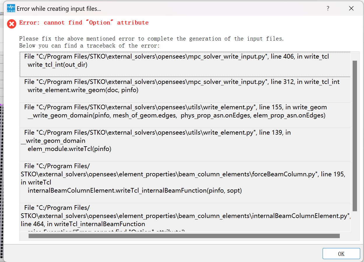

Dear STKO team, can you tell me how to deal with the problem as following.
STKO ERROR.png (95.07 KiB) Viewed 3299 times

It seems you are using directly a Section physicalPropery with a disp(or force)Beam Column element.
You should instead use a BeamSectionProperty (as a physical property), where you specify both the section and integration scheme

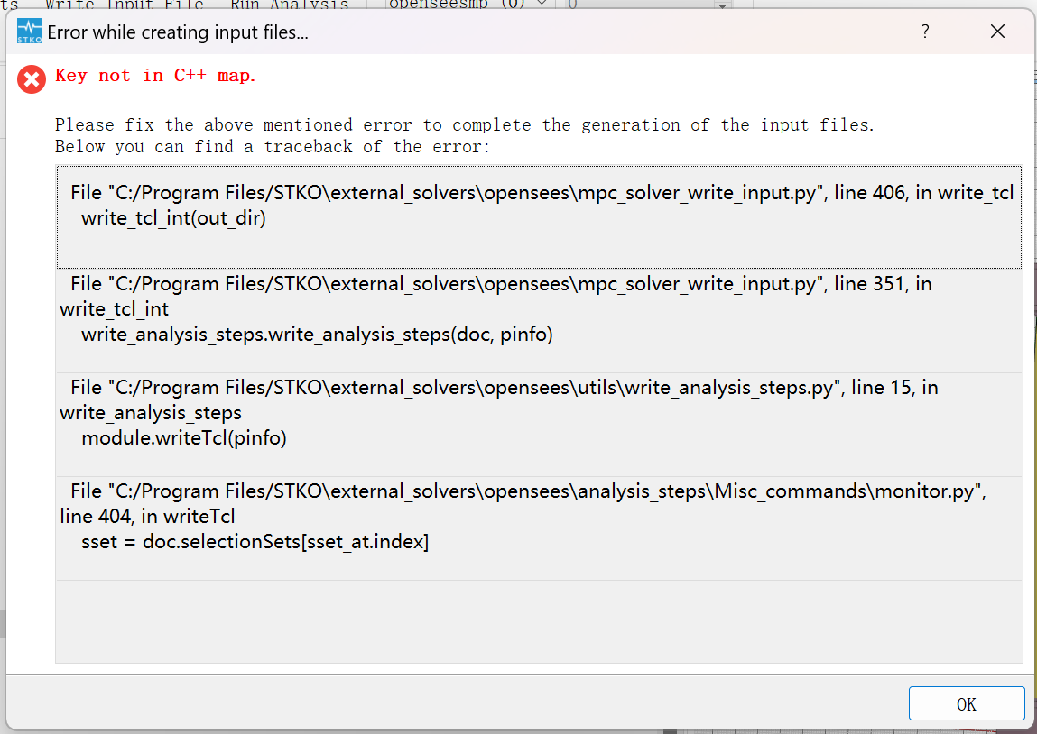

Thank you very much, your advice is useful. But now there is a new problem as following. can you give me some advice?
STKO ERROR can't find key.png (67.71 KiB) Viewed 3268 times

You did not select a proper selection set in the monitor. Double check it
