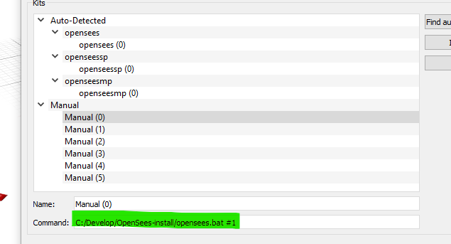

It looks like you are using a custom OpenSees.
Don't forget to put the #1 string after your opensees executable. The #1 string is a placeholder that STKO replaces with the tcl file name to run. If you omit it, it will show the error you mentioned.
Moreover, if your OpenSees solver is a parallel OpenSeesMP, you should also include the #2 placeholder that STKO replaces with the number of processors
