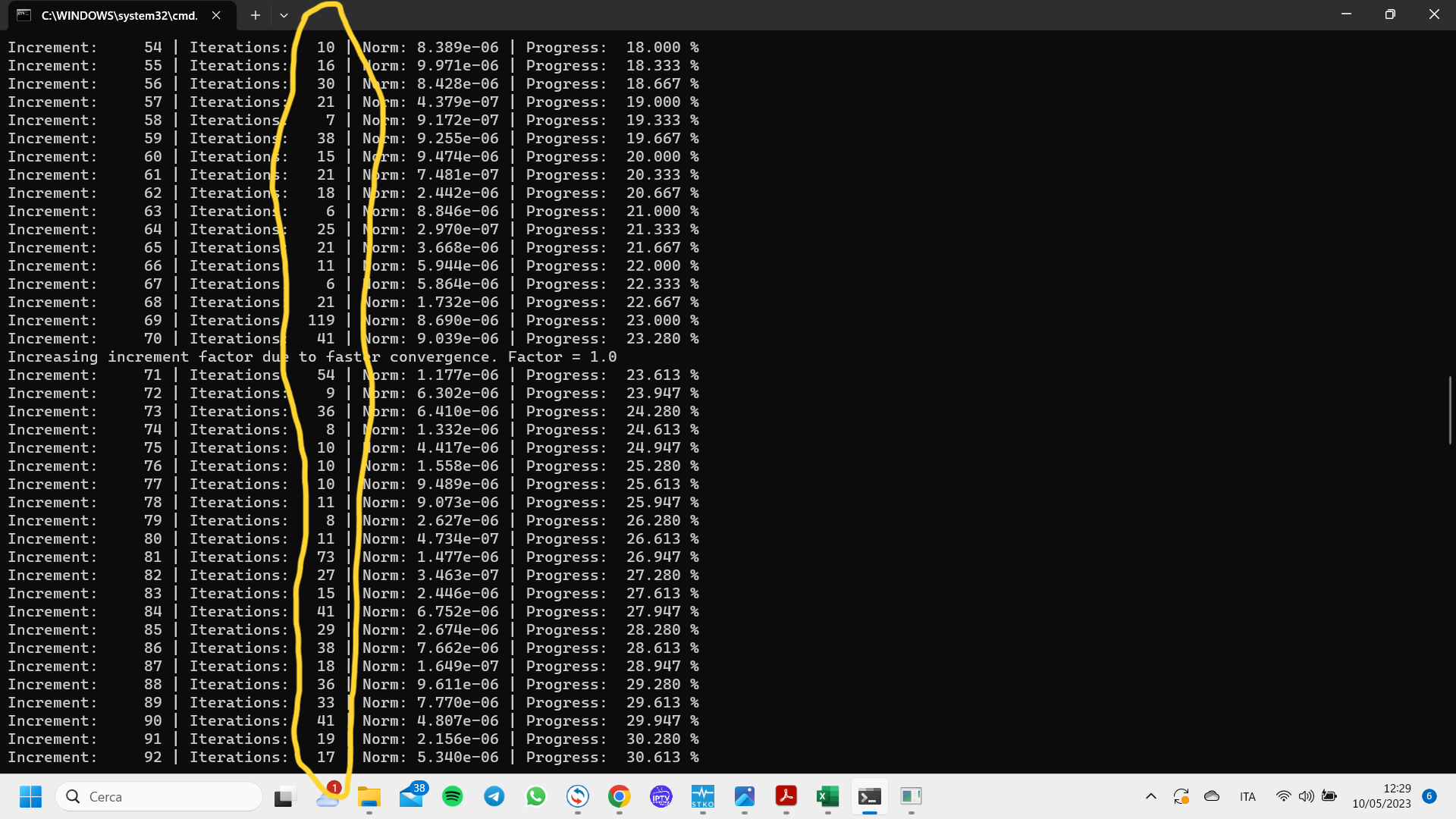

I modelled an infill masonry wall in 3d because I want to study the out-of-plane behavior. In particular, I used 2d elements in xz plane. I set a pushover analysis with displacement control to understand the in-plane behavior before. However, the computational cost in term of time is very big! In particular, in the best of cases after 1 hour of analysis the process is still at 50% because it needs many iterations for each increment.
Are there any options in the analysis setting that allow to reduce the iterations? Or other solutions to make the analysis faster?

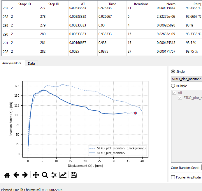

Try this:
S1A_pushover_damage_original.zip
(777.4 KiB) Downloaded 159 times
22 mins for the whole analysis:

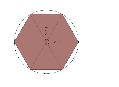

  • Use the smallest number of fibers that keep the section symmetric (an hexagon in this case) You don't need a fine mesh for rebars.

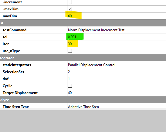

  • In the analysis use 30 max iterations (and put the double in the maxDim of Krylov, because with adaptive time steps we allow 2*maxIter, so in this way, Krylov updates the tangent matrix only once per time step)
    Also, use a larger tolerance. you are modeling in mm, and an absolute error norm of 1.0e-5 mm is very hard to reach when you have so many nodes
