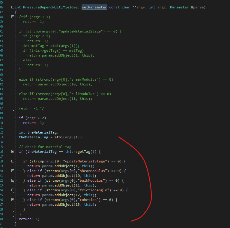

I am using the RandomizedMaterialWrapper to map soil variabialities on the PDMY02 model and using setParameter command with a randonmaterial table to update permeabilities and match void ratios of the elements with the void ratios of the PDMY02 model defined above.
I was wondering if the syntax of the setParameter random table is the same than the RandomizedMaterial Wrapper table.

Post by STKO Team » Tue May 16, 2023 10:21 am
I was using something like this. Will it work? Will it work on parallel? The elements are SSPQUADup
Yes, it uses the same format. The issue is that in OpenSees, the PDMY02 does not allow you to "update" those parameters:
That's why we introduced the randomizer wrapper, that changes the parameters directly in STKO.
