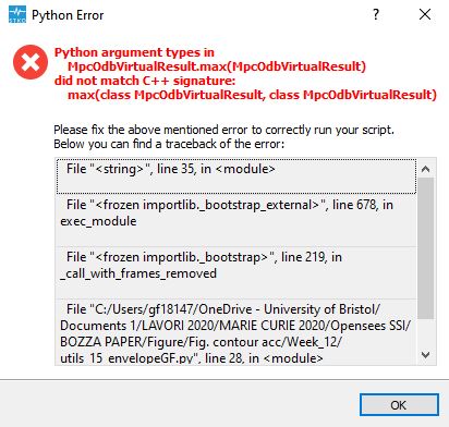

I am trying to use Python API to visualize the envelope of minimum and maximum accelerations for each node of the mesh. I have followed the example of the Getting started Week 12 example, Utils 14 and 15 (load combination and envelope).
In my case I just want to get the envelope of the accelerations (it is a transient (seismic analysis)).
If I understand well, the basic code should be something like this:
from PyMpc import *
from PyMpc import MpcOdbVirtualResult as vr
App.clearTerminal()
doc = App.postDocument()
db = doc.getDatabase(1)
result_names = ['Acceleration']
result_labels = [
	['Ax','Ay']]
R1 = db.getNodalResult(
	'Acceleration (Volumes',
	match=MpcOdb.StartsWith,
	time=vr.stageEnd(3)
print(type(R1))
env_max = vr.max(R1)
env_min = vr.min(R1)
env_max.setDisplayName('(ENVmax) Acceleration')
env_max.setComponentLabels(['Ax','Ay'])
env_min.setDisplayName('(ENVmin) Acceleration')
env_min.setComponentLabels(['Ax','Ay'])
db.addVirtualResult(env_max)
db.addVirtualResult(env_min)
Until line 23 "print(type(R1))" I don't get any errors, then for env_max I get the following error:
Is this a problem connected with the fact that I am using OpenSeesMP?
How can I modify the code to make it work?
Thank you very much

Re: Envelope of accelerations in OpenseesMP with API
Post by STKO Team » Wed Apr 19, 2023 3:03 pm
The error is saying that you called max (and min) with only one argument:
Instead in the util you are referring to, we were doing the envelope of 2 results:
env_max = vr.max(R1, R2)
env_min = vr.min(R1, R2)
But if I understood correctly you need to do the envelope of a single result in time.
Have a look at webinar #20: Intro to STKO v2.0's Python API

Hi, thank you for the clarification. Actually, when I say envelope I would "only" need the maximum (positive) and minimum (negative) value reached in terms of acceleration for each node.
The problem is that (of course) the maxima are not simultaneous for all the nodes, so when you write:
Instead, a virtual result is an instantaneous result, i.e. an operation among multiple results at the same time step.
it seems to me that the most efficient way to do that is to extract the maximum and minimum acceleration for all the nodes and download it as a file, and after that plot the results outside the STKO post-processor. Of course the file should contain the coordinates of the node together with the acceleration values.
What do you think?
Post by STKO Team » Wed May 17, 2023 3:42 pm
Yes now you can do it like this.
