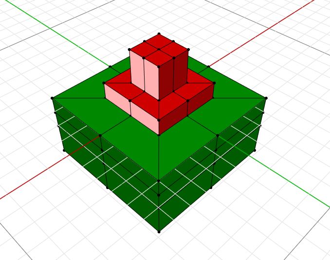

Dear Forum,
I am building a model for a footing overturning from a horizontal load. At the moment I am using a fully connected model by merging however the resulting load displacement is not correct. I want to use 2 merged blocks instead (footing and soil) and create an interaction between them. SSP Elements are used for the solid elements. What elements and properties should I use and how do I draw the interaction (node to node?)? The parameters I am aiming to add is 15 degrees friction angle or 0.177 mu to this interaction, if needed the Youngs Modulus is 25 MPa and Poissons Ratio of 0.3. I have attached a test file for demonstration of what I am trying to achieve as well as an image. Note part of the footing is in the soil not just sitting on top.
Many thanks!

Thanks for the response. I have watched the webinar and tried applying it to my model. However, I have not managed to get it working. I have attached a simplified version I was using to test the elements on but it doesn't work. I managed to get 2 blocks of the same size to work but with the lower block being larger it doesn't work.

I see a few problems in your model:
1. you are using a contact element with orientation type from the local axis, but you don't assign the local axis.
2. I would keep geometry in a way to have uniform mesh
3. Check that you are coherent in units of measurement for your material properties and applied loads. You apply 20200 as a volume force, keep in mind that it will be multiplied by the volume to which you assign it. In your case by 1000 (10x10x10)
I have changed the contact as in the webinar in the last example for the slab-soil, in this case, you can also use finer mesh for your footing. It runs with a smaller value of the load, but you need to look into the parameters.
Let us know if you have any trouble.
Valentina
