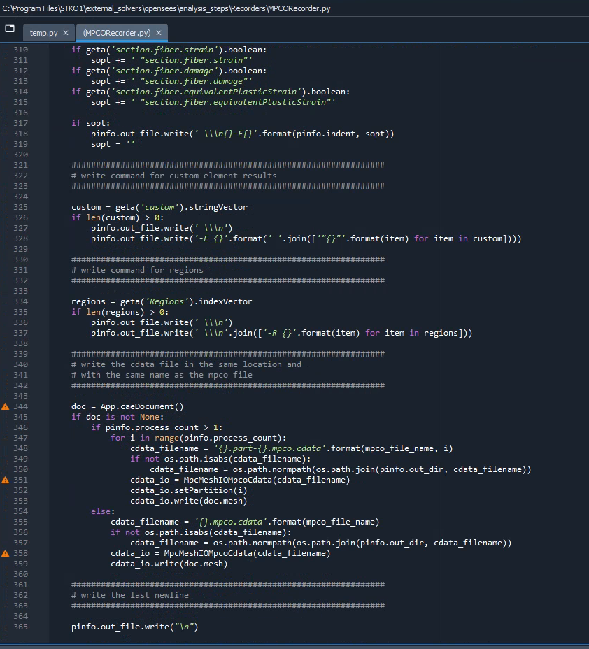

I believe it is this in the picture
- cdata_stko.PNG (573.26 KiB) Viewed 3144 times
Re: Beam extrusion
Ok, that is the file.
The *.mpco.cdata file is created at line 353, if you are using parallel processing (OpenSeesMP), or at line 359 if you are using only 1 process (OpenSees).
That function (cdata_io.write(doc.mesh)) will create the *.mpco.cdata file and write on it. If something goes wrong, you should see a red error message in the STKO's Terminal window.
Did you receive any errors while creating the Tcl files?
If you did not receive any error, it might be that either the mesh is None (but I don't think this is possible because STKO would have stopped before), or the system did not allow to create a file on that location.
Have you tried to save the file in a different location?
