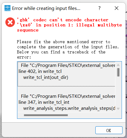

Dear STKO Team:
sorry,i have not solved the problem, the error code is not actually same,i double checked the directory,and run a simple analysis in same folder,it could be done
- 2.png (11.58 KiB) Viewed 2498 times
- 1.png (22.21 KiB) Viewed 2498 times

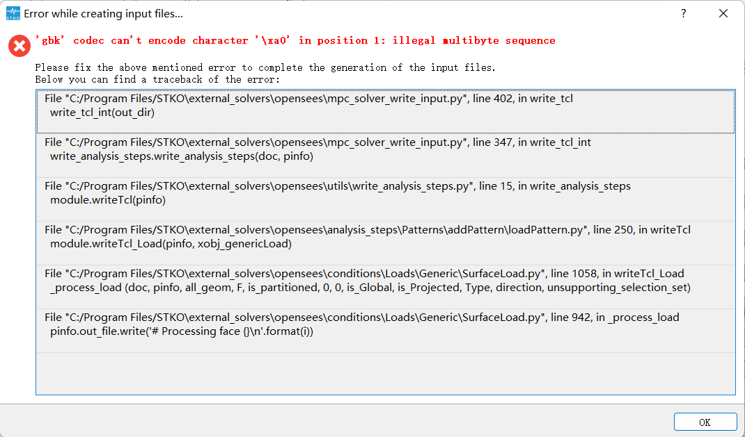

Dear STKO Team:
sorry,i have posted enlarged image and file,i just downloaded ex4 from official website,and i didn't change anything
- ex4.zip
- (194.19 KiB) Downloaded 176 times
- error.png (46.81 KiB) Viewed 2491 times

We just found the issue.
It's strange that it happens only to Chinese users.
There was a problem with the formatting in the SurfaceLoad.py python file.
Here's the updated file: Unzip it, and copy it to C:\Program Files\STKO\external_solvers\opensees\conditions\Loads\Generic, replacing the existing one.
The new version of STKO will have this issue fixed.
