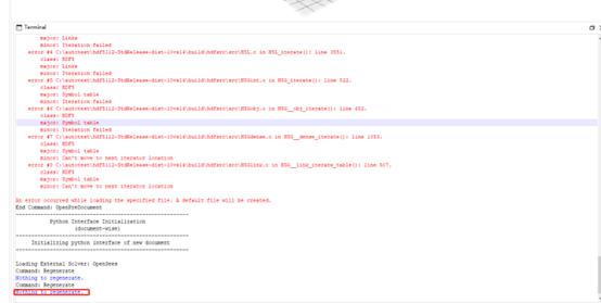

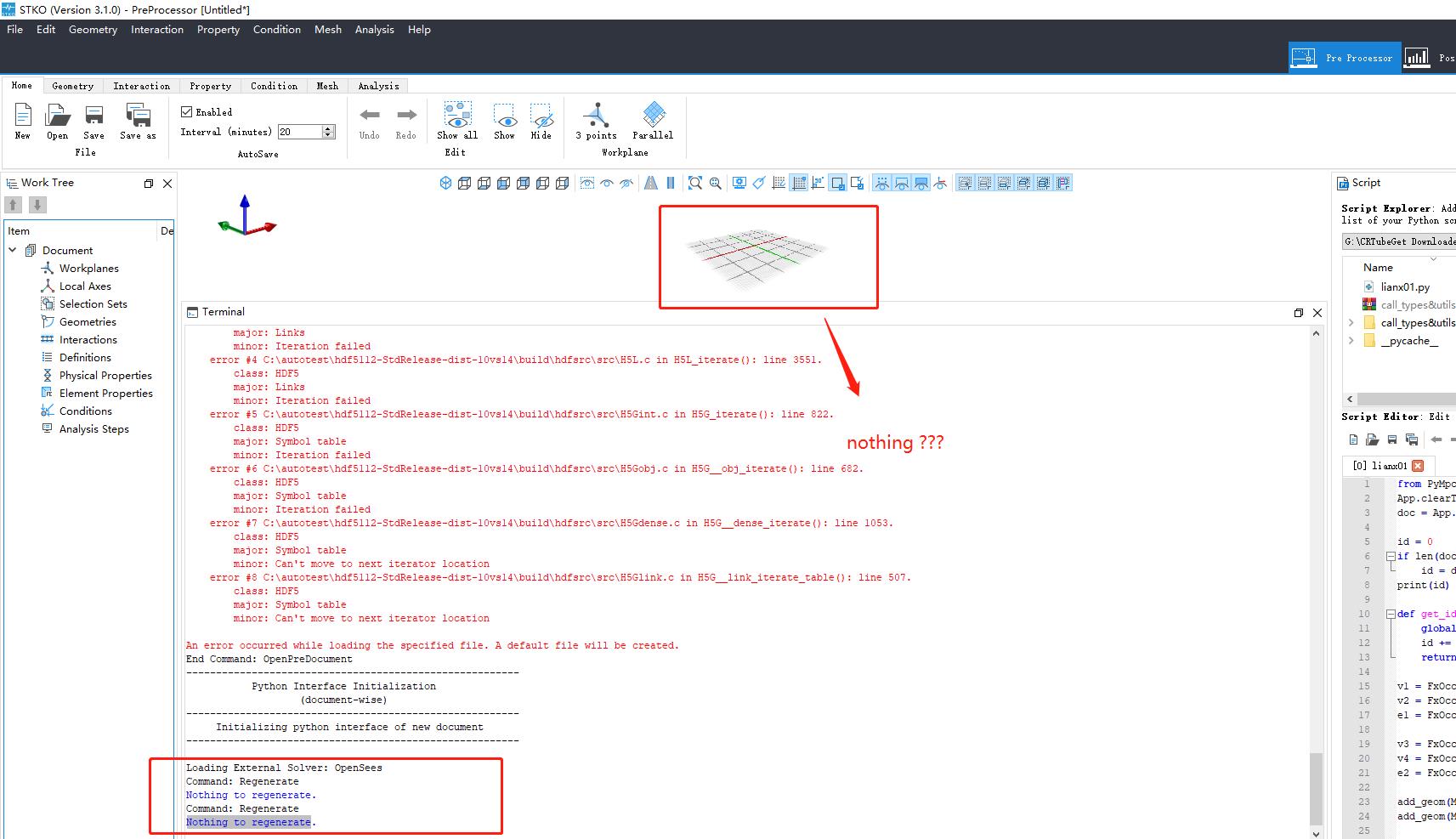

I am very sorry that I have met a problem and need your help. When I used STKO software, my software occasionally appeared to blink back, and when I opened it again, there was nothing. I have encountered the same situation 5 times when I was simulation different experiment. I spent a week on one model, but I have nothing. Can you help me? I have been a bit alarmed about this situation because I need to constantly adjust the model, but I can't save different versions all the time dear SKTO team.

It's because you have some inconsistencies in your file.
There is a selection set that is referencing an interaction (ID = 8) that does not exist in your model. I found it reading the error (RED) message in the terminal.

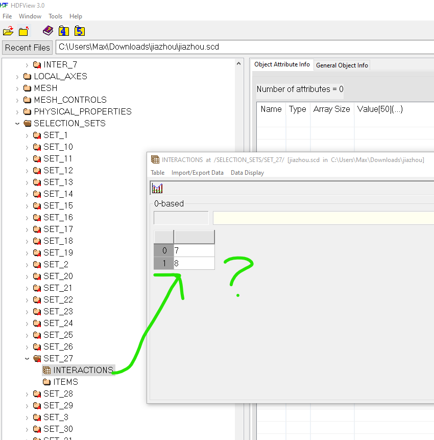

Then I opened the file in the (free tool) HDFView:
How did it happen? Did you make this file using a Python script? Probably there was a mistake in the script.
Anyway, using HDFView I managed to change that INTERACTIONS Dataset to have only the ID = [7], instead of [7, 8].

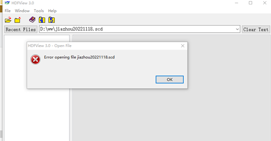

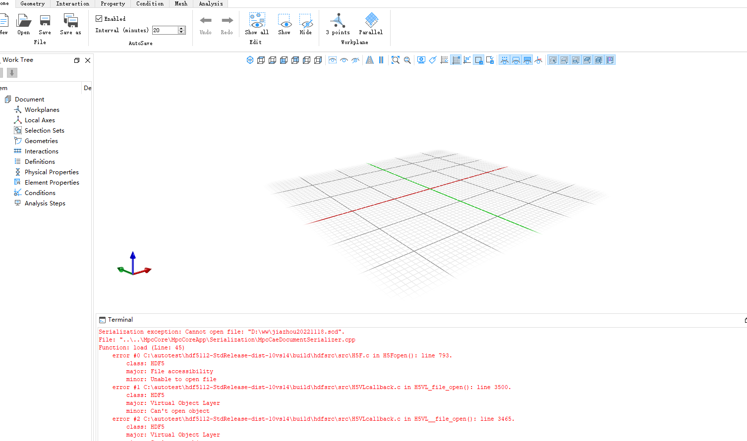

I'm sorry that I encountered the same problem again. My other model crashed. I want to know how you solved this problem. Can you teach me? When I open it with HDFView software, an error is displayed. My model was built with STKO software, not Python. When I consulted my colleagues around me, they also encountered this devastating problem.

I'm sorry but the problem with this file is different. It says it is corrupted and cannot be opened.
Do you know when the crash happened?
Can you reproduce it on another file so that I can debug it?

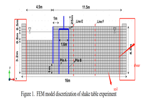

I'm sorry, many crashed files have been deleted, but I often encounter. I have a question about boundary conditions.
I did a centrifuge test on a saturated soil slope site (similar to the case on STKO website), using a shear box. I encountered some problems about the boundary. When I used the energy boundary calculation provided by the website, it often failed to converge(When counting strong-earthquakes liquefaction). Regarding the slope site (PDMY02) boundary, do you have any good suggestions in this regard? Do you have any good suggestions about this? I have been puzzled about this problem for a long time, and I have been unable to find a good solution to deal with it

I think none of those approaches are correct.
I understood that you are simulating a centrifuge test, so you should replicate those boundary conditions.
Free field or absorbing boundaries are not correct.
Typically they use periodic conditions for centrifuge tests. But it might be a problem for slopes.

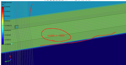

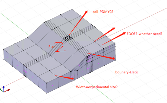

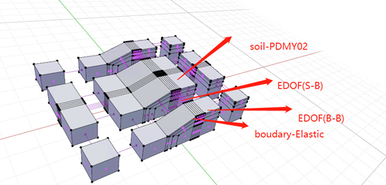

My models are all inclined, and the boundary has a great impact on my settlement results. The conventional shear beam boundary cannot be used. There are too many models to upload completely. I have provided an elastic model.

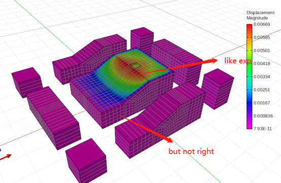

3. According to the centrifuge test, should my boundary adopt the following scheme (1) or(2)?
4, I want to know my model the boundary of the material whether to adopt and shear box in the experiments of the same material (elastic) (HTTP: / / https://www.researchgate.net/publicatio ... Pile_Group _response_subjected_TO_induced_large_ground_deformation_in_e-defense_shake_table_test), or PDMY02 (the same as below)? However, my model does not work, can you help me to look at it?

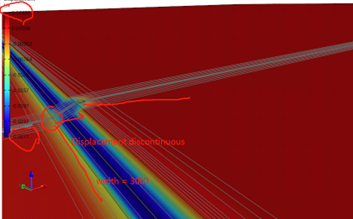

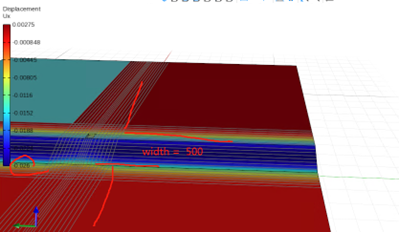

5. Should the width of the model box be the same as that of the test shear box? However, based on my recent research, I found that width has a huge impact on the results,
I think that none of the two are representative of the centrifuge test conditions imposed by the box.
Why don't you try to model the real setup?
For example, you can model the steel box, and the material between the steel box and the soil (I've seen that sometimes they use materials to minimize wave reflections)
What is stated in opensees website about using a Thicker column, is to simulate the free field, which is not applicable to your example.
Yours is a centrifuge test.
