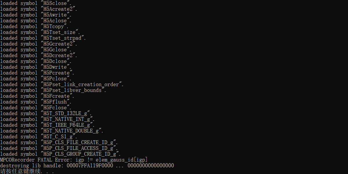

I have incoporated a zerolength section element in my model, but when I run the model, a error as below was appeared.
I found it is a bug for stko in this disscussion: viewtopic.php?f=45&t=1949&p=3574&hilit= ... tion#p3574. Image.
Have it still not been sovled? And if I want to use the zerolengthsection element in stko, how can I solve this problem.

Post by STKO Team » Wed Nov 09, 2022 9:09 am
It has been fixed
Download the latest OpenSees-Solvers version from here: https://www.pucp.edu.pe/profesor/sabino ... ducciones/
