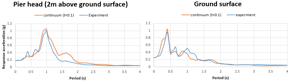

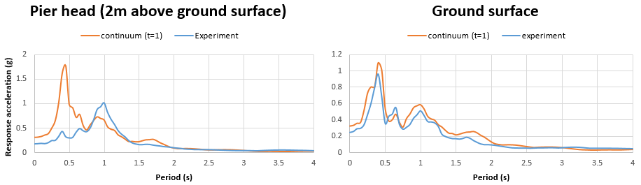

Could you kindly clarify the significance of element thickness in plane-strain elements? I tried searching this forum, but there is not much information regarding this topic. I carried out a 2D pile-soil interaction analysis and tried to validate the model with an experiment. At first, I took the thickness of quad elements and absorbing boundaries as 1 (note that the units I used are kN, m, s). The ground surface acceleration was matching, but the pier head acceleration was not. I played with so many parameters, but all in vain. However, on changing the thickness to 0.1, the result matched for both ground surface acceleration and pier head acceleration.
Therefore, I would like to know how is the element thickness actually affecting the results. It is not just the magnitude that changes. I am attaching the figures for your reference.

The plane-strain is a 2D simplification of a 3D model.
When you have a uniform model (for example, only soil), you can use whatever thickness you want. You just need to be consistent with the load you apply. And the result will be the same, the only difference of course will be the magnitude of the reactions that scale with the thickness
In your case, when you have a pile, which has a physical cross-section size, a change of thickness in the plane-strain will result in changing the relative stiffness between the soil and the beam (whose cross section remains fixed).
So in this case you should use a thickness which is exactly the same size of you have in the experimental test
