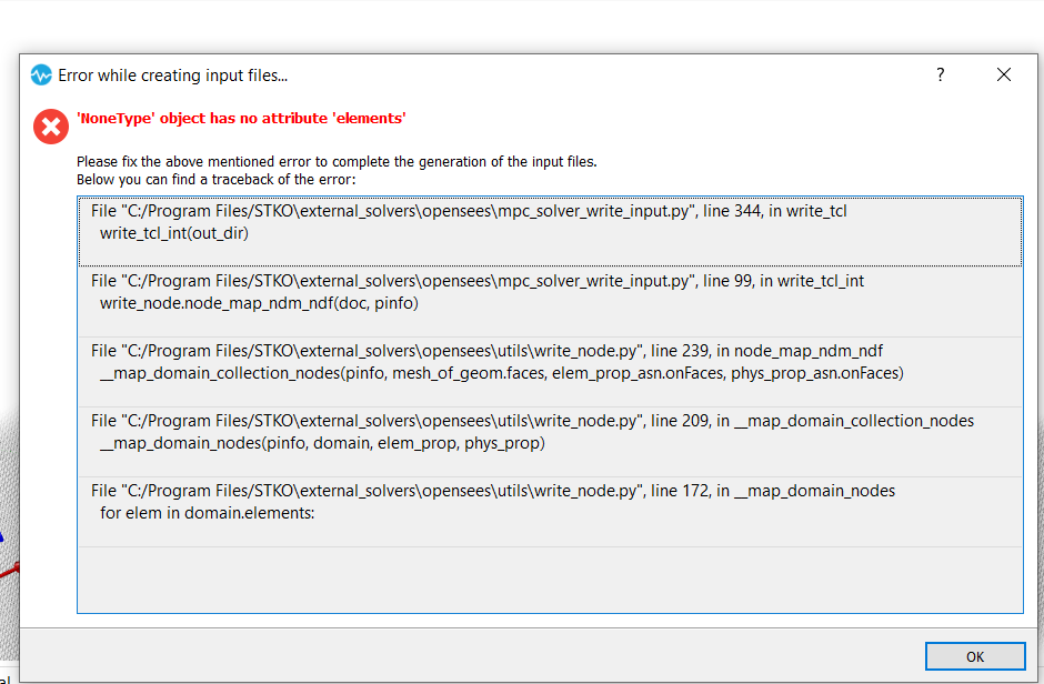

Hello STKO team,
I am developing a model for a mixed masonry-RC building. The model was initially imported from AutoCAD and only then I modified some details. All the masonry walls are represented by the TC3D damage model including an RC wall. The RC beams and columns are represented by fiber cross-sections.
The issue I am facing is attached below and I would appreciate a closer look on it. I made sure that there is no any geometry with out element/physical assignment, but it didn't appear resolve the issue.
I am happy to send the .scd file of the model (I couldn't attach it with along this message for some reason though).
Looking forward to your response!
- error.png (45.93 KiB) Viewed 4707 times

If you look at the last line, it says that (line 173) the "domain" object, on which STKO is trying to call the ".elements" property, is None.
This means that you meshed your geometry, but some parts of it could not be merged for some geometry error. In the mesh view, try to identify the geometry (typically a face) that could not be meshes (you will see it as a transparent face), or look into the Terminal messages, there you should find some details

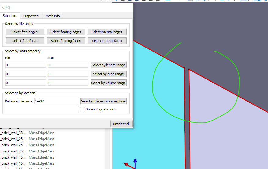

The are some mistakes in the boundary conditions:
Yes, the RepairFix works in most cases (and yes, you lose material and element assignments) but is not magic... The approximations in the AutoCAD o-snap created other imprecisions, in fact, there are some warnings regarding some floor nodes not being in the XY plane. This happens when some nodes are at a Z coordinate which is different from the Z coordinate of the master node.
Another issue is that some of your faces are not attached due to the above-mentioned approximations.
I used the QueryGeometry tool to highlight the free edges. Free edges are edges which are borders of only 1 face. So you should see them only at windows or door openings, bot not in the middle of a wall.
Instead, there are many places where this happens: If you zoom in, you can see that there is a small gap between the faces, this creates a cut in the wall, and that piece of wall is completely detached from the building, therefore your matrix is singular.
You need to fix this issue before running the analysis.
- The fix of the floor master nodes is not included in the constraint pattern
- The "perpDir" attribute in the rigidDiaphragm conditions should be "3" because your floor are in the X-Y plane.
