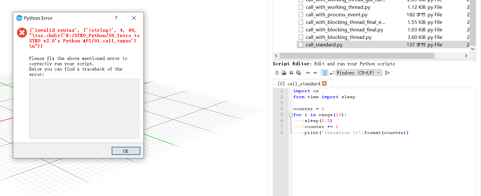

I ran the python, but it showed errors. What's the problem. Thank you

Is your file saved with the .py extension?

Please remove the "single quote" from the script directory after the 2.0:
... v2.0' s Python ...
Thank you for spotting this issue. We just fixed it for the next STKO version
