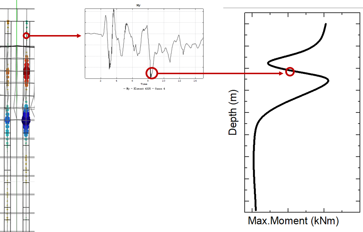

I try to extract the moment envelope graph of a pile subject to an earthquake time history. I found it is a little bit inconvenient to manually select part of the gauss point for plotting the moment envelope graph (I don't need all gauss points to get the envelope graph). I wonder if it is possible to select part of the gauss point (like the first gauss point in a beam element) in STKO?
From your webinar on youtube, I know that maybe the Python API can be used to extract the max moments of a pile. Unfortunately, I am not familiar with the python language. I wonder if is there an easier way to get the envelope graph of structural components in STKO.

Thanks for your quick reply. Maybe I didn’t express my thoughts accurately. Using the "Particle shrink factor" makes the selection much easier, but I don't need all of the gauss points. What I want to do is hide some gauss points, because I don't need all the gauss points in an element to plot the graph.

Hi Zhang Bin,
sorry I did not understand your question initially.
In this webinar, #12 at this link
https://asdeasoft.net/?get-started-webinars
I gave two example scripts to create load combinations results and envelope results.
Maybe you can try to edit them and adjust them to your problem.
Make an attempt and let us know if you need help
