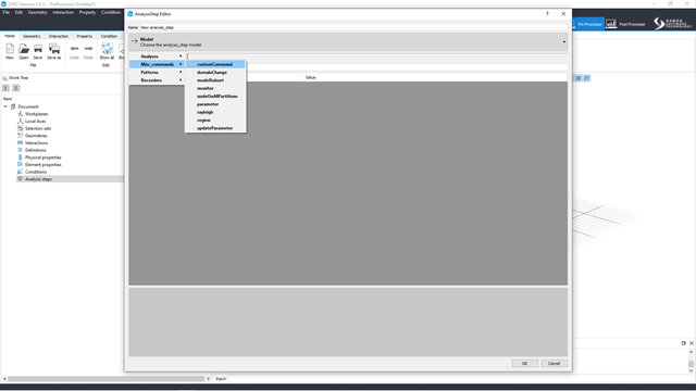

Dear youngkyu ,
you have two options:
1) You can add to the analysis the custom command (see picture) and write:
# record nodal displacement, acceleration, and pore pressure
eval "recorder Node -file Results/Gdisplacement.out -time -node $nodeListS -dof 1 2 disp"
2) The most elegant and effective solution (but more complicated) is to use API python interface (https://asdeasoft.net/?webinar), you can implement basically everything, it is incredibly powerful.
Regards
