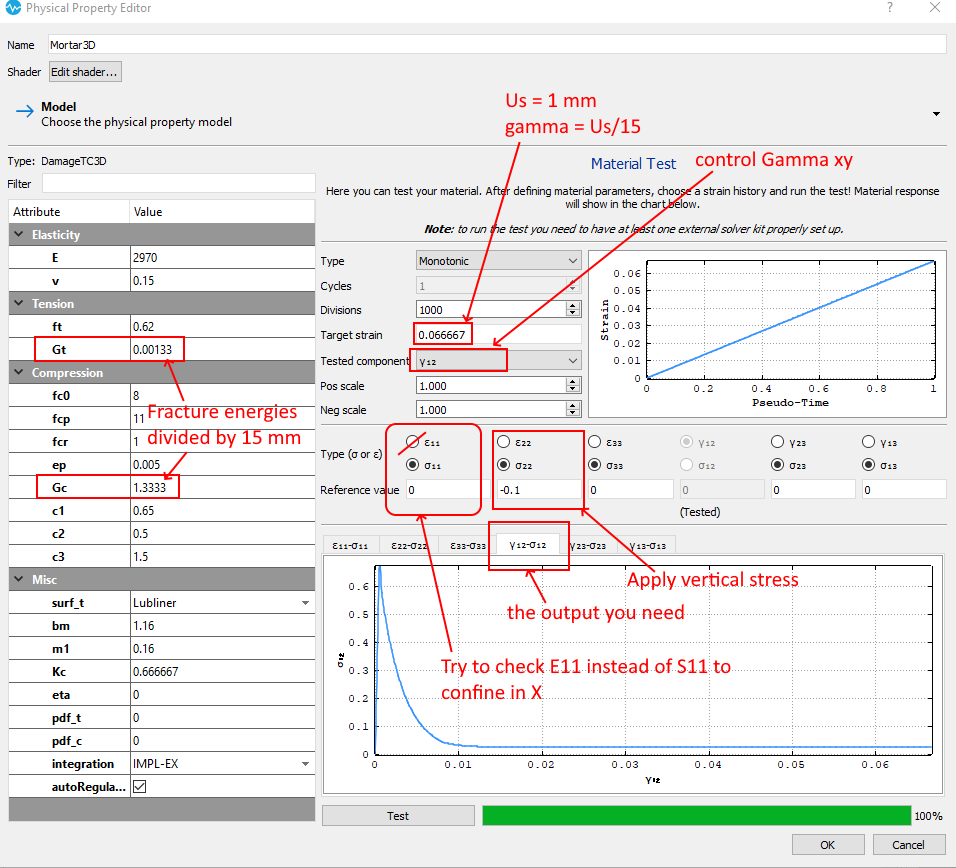

You can do the same without creating any mode, just use the material tester:
Re: Elemental Shear Test for Mortar Joint

Thank you for providing me such a detailed answers. Sincerely appreciate your timely responses. I just explored a little further based on your suggestions. For the models with right-bottom node Ux fixed, the results improved; actually, out of those two models (1mm and 15mm), 1mm model performed better than 15mm in every aspects. I also explored the material tester. It is a really valuable suggestion to quick idea. Yes, eps_11 of about of 0.0004 to 0.0006 (negative) gives nice results! I observed that for increasing confining pressure in Y direction, I had to also increase the confining strain in X direction.
