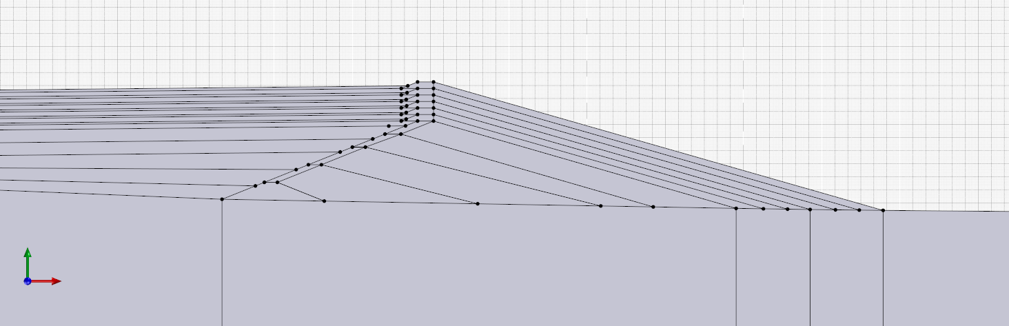

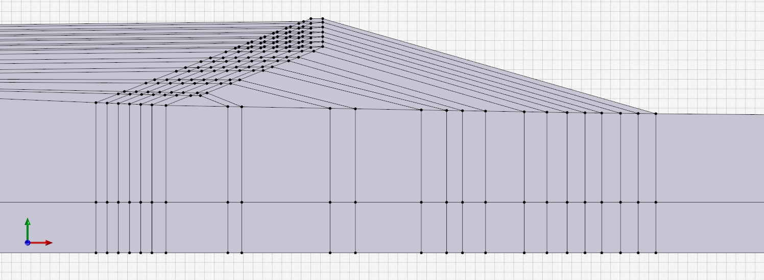

I've been working with a staged model with a complex geometry (tailings dam). I've drawn all the stages as quadrilaterals, but when I try to quad mesh the geometry, I get some triangles in the model. How can I get rid of them?
I'm attaching a couple of photos of my model.

- Screenshot_2.png (276.1 KiB) Viewed 6274 times
- Screenshot_1.png (102.82 KiB) Viewed 6274 times

Dear user,
To obtain structured mesh (quad) you need to have the surfaces closed by 4 edges and if you check your model you have some surfaces closed by more than 4 edges.
Remember that for structured meshes, you always have to be sure to have the surfaces closed by 4 edges.

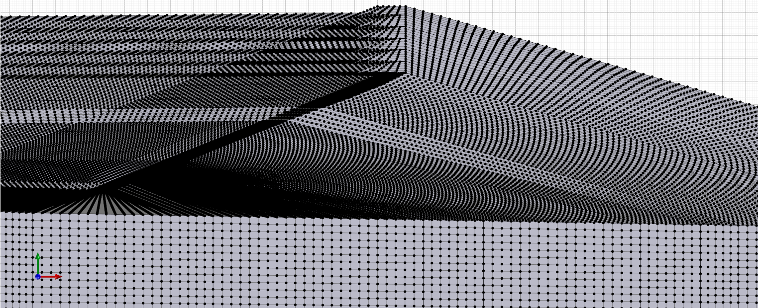

I've changed the geometry as you said and I'm getting all quads now.
Unfortunately, I'm getting a high densification of the elements at some parts of my model. I've tried changing the edge seeds at the troubled zones but doesn't seem to help. Also I Tried changing to a unstructured mesh to some surfaces but I get triangular elements.

- Screenshot_2.png (510.55 KiB) Viewed 6258 times
- Screenshot_1.png (112.93 KiB) Viewed 6258 times

Changing the edge seed in those thiny surfaces won't help you, because the maximum mesh size will always be at least equal to the size of the surface.
The option you have is to create trasition zones, but it takes knowledge in preparing a good model that is suitable for structured meshing.
Probably you cut your soil surface into too many unecessary pieces. Try to post a sketch of what should be your soil model, so that we can help you in building a clean model for it.

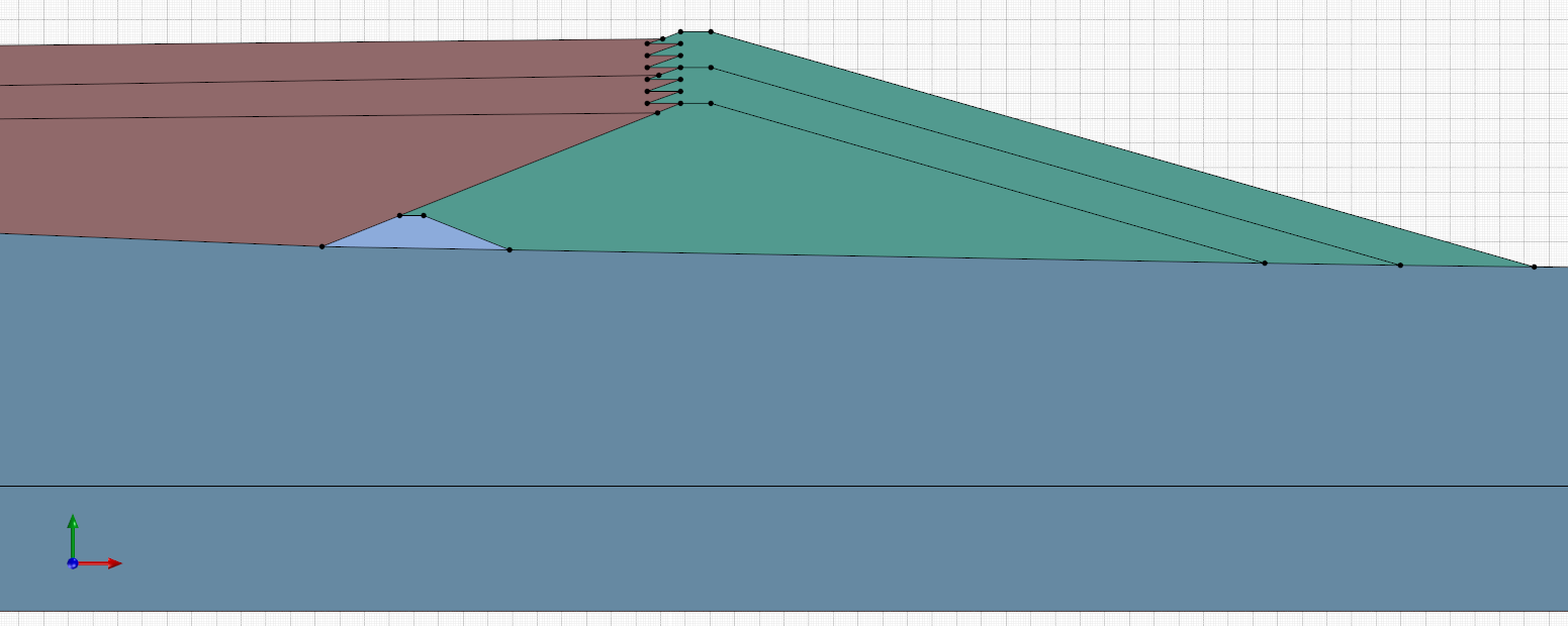

Okay. So I attached the a sketch of the model I'm trying to build.
Those spikes at the top of the latest stages of the tailings dam are causing me a lot of trouble. Sadly, I can't get rid of them because they are close to the max deformation zones of the dam at the very top.
I added colors to make the different soil materials more noticeable, and the intermediate lines at the green section are just to represent some stages.

- Screenshot_1.png (82.23 KiB) Viewed 6244 times
