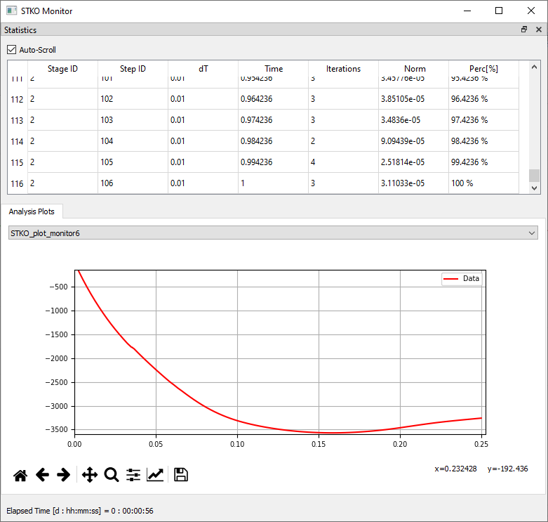

Re: Infill-RC Frame Interaction with element removal
Here is the corrected file that now reaches the end of the analysis.
The main source of error was due to the fact that, for this kind of element removal, the only system that works is the BandGeneral, because it is the only one that correctly resizes the system matrix after element removal triggered by the remove recorder. Hopefully the OpenSees developers will fix the incompatibility with other system command soon.
Then I also changed the time-step method from Fixed to Adaptive, so that when it encounters a convergence problem, instead of stopping, it tryies to reduce the time step to overcome the convergence issue.
Finally I also included the monitor step (not mandatory), which is very useful to plot the load-displacement curve in real time during the analysis

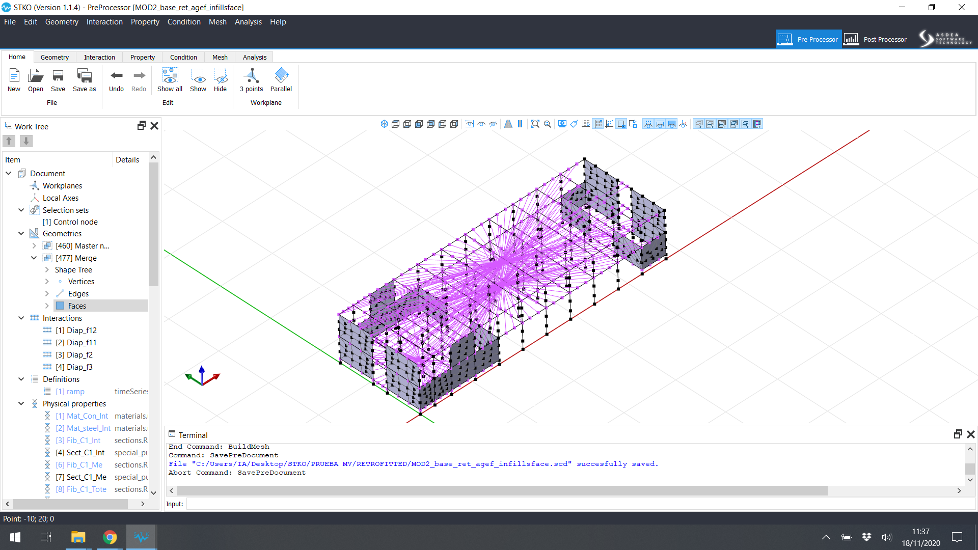

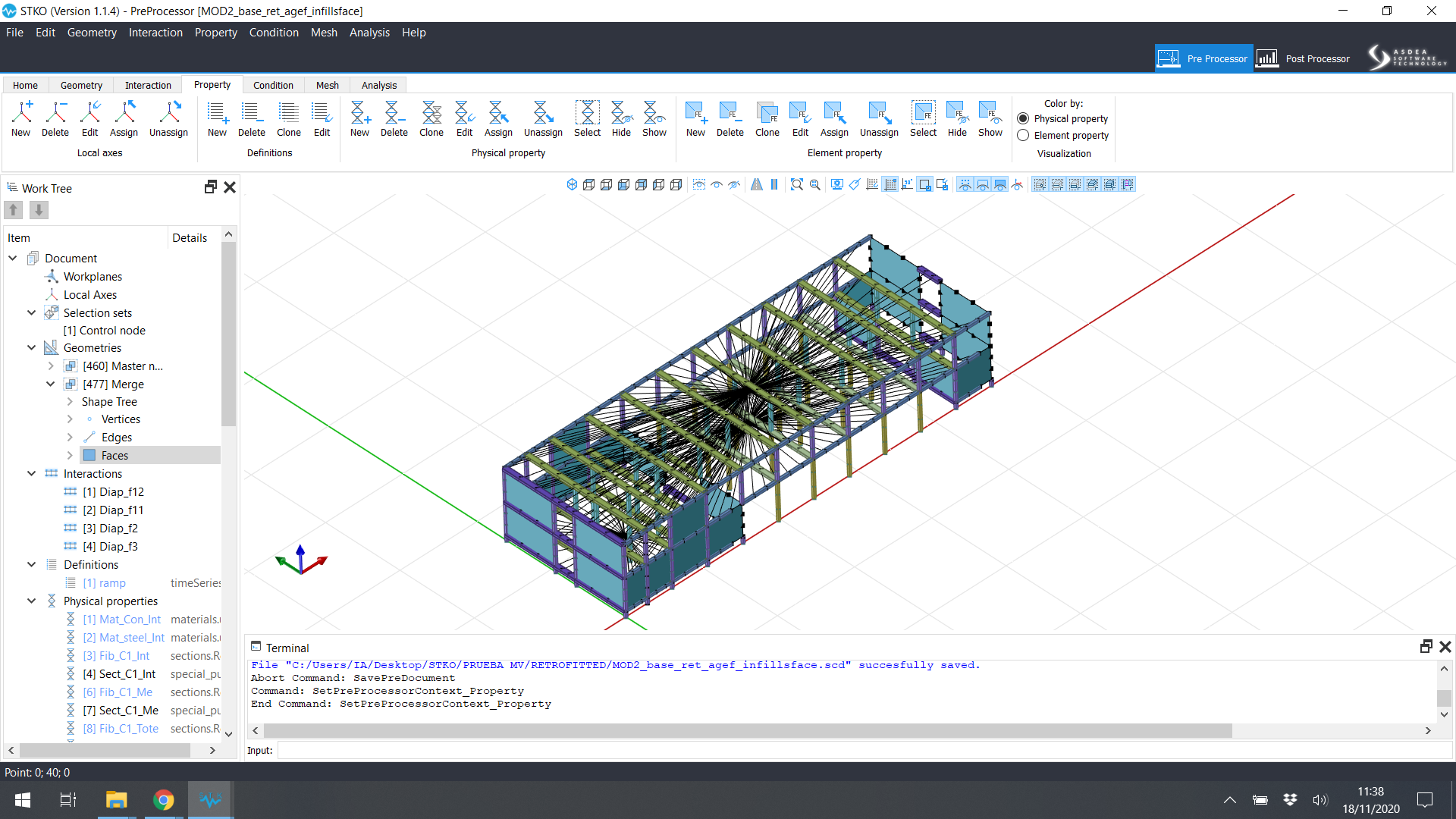

Hi again,
I tried to model the infills in this new model in which the RC elements are divided to be retrofitted.. The thing is that when I tried to mesh the faces, they are divided into squares due to the other elements divisions. I do not know what to do so that the faces can be divided into one to obtain the trusses.
Also, when I merged the wire with the faces, some elements properties disappeared. I tried to add them again but they do not appear and I think that they might not be considered during the analyses. The boundary conditions are also missing and I can not define them again.
Regads.
Regads.
- Captura de pantalla 2020-11-18 11.38.03.png (436.8 KiB) Viewed 6976 times
- Captura de pantalla 2020-11-18 11.37.57.png (393.96 KiB) Viewed 6976 times
- MOD2_base_ret_agef_infillsface.rar
- (282.89 KiB) Downloaded 901 times

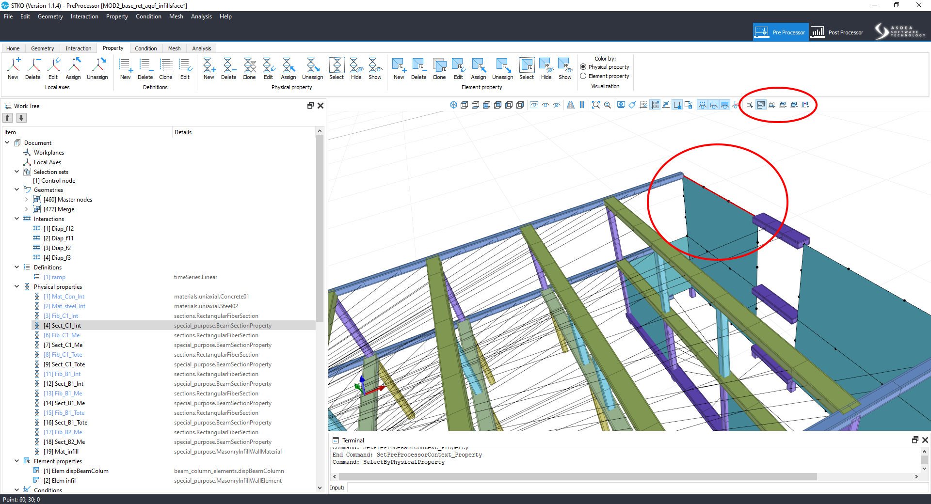

No, it is weird... With the corrected file that I sent you, I reach the 100% of the analysis:I have analysed the model and the pushover curve stills stops at a very low percentage... There is still a convergence problem. I think that for nonlinear analysis this procedure is not suitable yet... What do you think?
Yes, unfortunately the Infill element, assumes that the face is discretized with only 1 quad element.I tried to model the infills in this new model in which the RC elements are divided to be retrofitted.. The thing is that when I tried to mesh the faces, they are divided into squares due to the other elements divisions.
If you really need to discretize your beams, then you need to:
- draw the frame and the faces as 2 separated geometries, in this way they can have a different discretization
- attach the corners of the faces with the corner of the frames with an interaction
- create an EqualDOF condition for that interaction. In this way, the 2 separated geometries will be "glued" together with kinematic constraits
It happens because when "merging" an edge with a property, with another edge (of a face) without a property, the "Merging" algorithm just pick one of them randomly, so it cannot guarantee that the property assignment will be held.Also, when I merged the wire with the faces, some elements properties disappeared
However you can re-assign it. You just need to go into sub-selection mode with only edges selectable, and then select your edges and drag-and-drop your property
