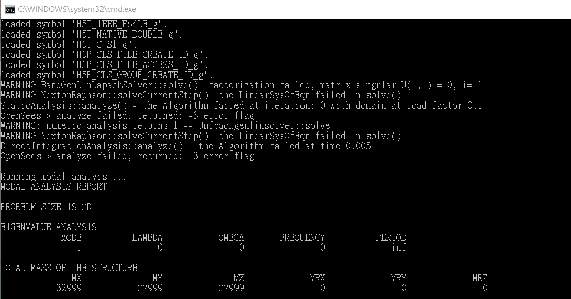

Dear STKO Team:
I try to build a column with plastic hinges (Lumped Plasticity).
I use elastic beam column and zerolength element to build my model, and apply Elastic Uniaxial Material on zerolength element.
But there is an error when I performed the analysis. The picture is the error message and the following is my model.
How could I solve the problem?
Any advices and helps that you provide are highly appreciated.

Re: Question about Nonlinear Modeling of RC Frames (Lumped Plasticity)
Dear user, that error means that your model is singular.
It happens because in the definition of the zeroLength material, you only assigned a uniaxial material in some of the 6 DOFs. This means that the other DOFs are released. If you want to create continuity in the other DOFs you need to put a stiff uniaxial material in those DOFs.
