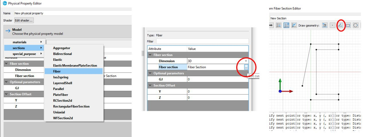

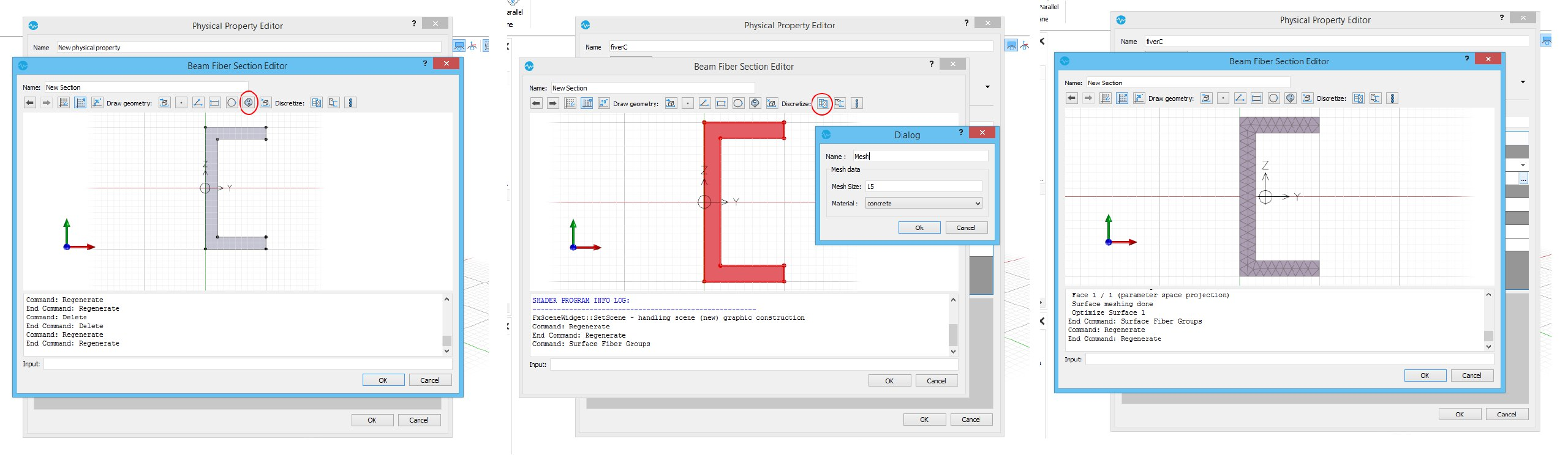

Hello, I would like to know if there is a way for creating patch on fiber sections in STKO. I´m trying to model C shaped walls with fibers.

Re: Fiber Section Patch
Hi David, Great question!
The patch command is an OpenSees command to generate a set of fibers in a quad-like shape. In STKO you can do the same by creating a new Physical Property -> section -> Fiber (see the attached images).
I hope that helps!
Let us know if you have any further questions about the process.
I hope that helps!
