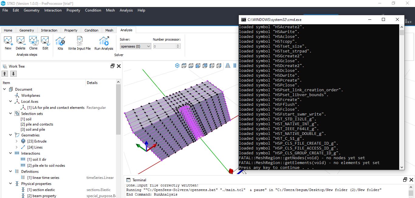

I am getting some kind of error (figure attached below) that I never encountered while using STKO. Therefore, I am not able to rectify it. Even after meshing the geometry properly, I am getting this message. The same files I have used before and there was no problem. Since yesterday this problem has occurred.
"FATAL::MeshRegion::getNodes(void) - no nodes yet set
FATAL::MeshRegion::getElements(void) - no elements yet set"
If anyone has encountered such kind of error please let me know what could be the solution.

probably there are problems with regions.
Can you post the model here so we can see it?

Please find the zip file attached herewith.

it is necessary to move the model subset named "add selection set- soil" up on top of the analysis steps list. You can do it with the arrow button at the top of the work tree.
