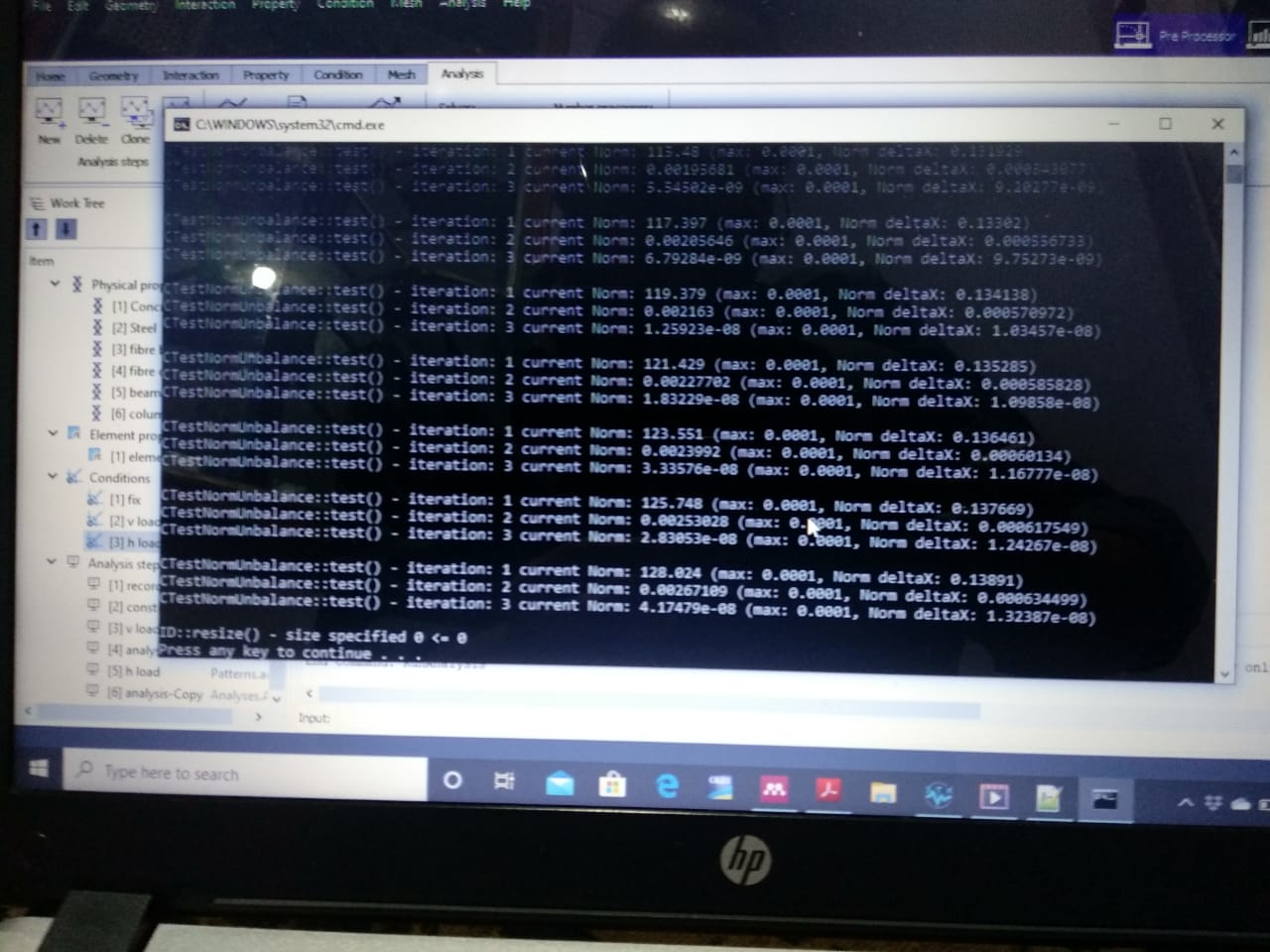

I am trying to perform a cyclic pushover analysis of RC frame with distributed plasticity. The Frame shows no error in case of gravity analysis. However, when subjected to cyclic loading an error occurs (ID::resize) as shown in the attached file.
Kindly help me in this regard.

Dear User,
don't you worry, ID::resize is not an error. The analysis performed well. You can open the results in Post Processor.
Please, let us know if you need something else.
