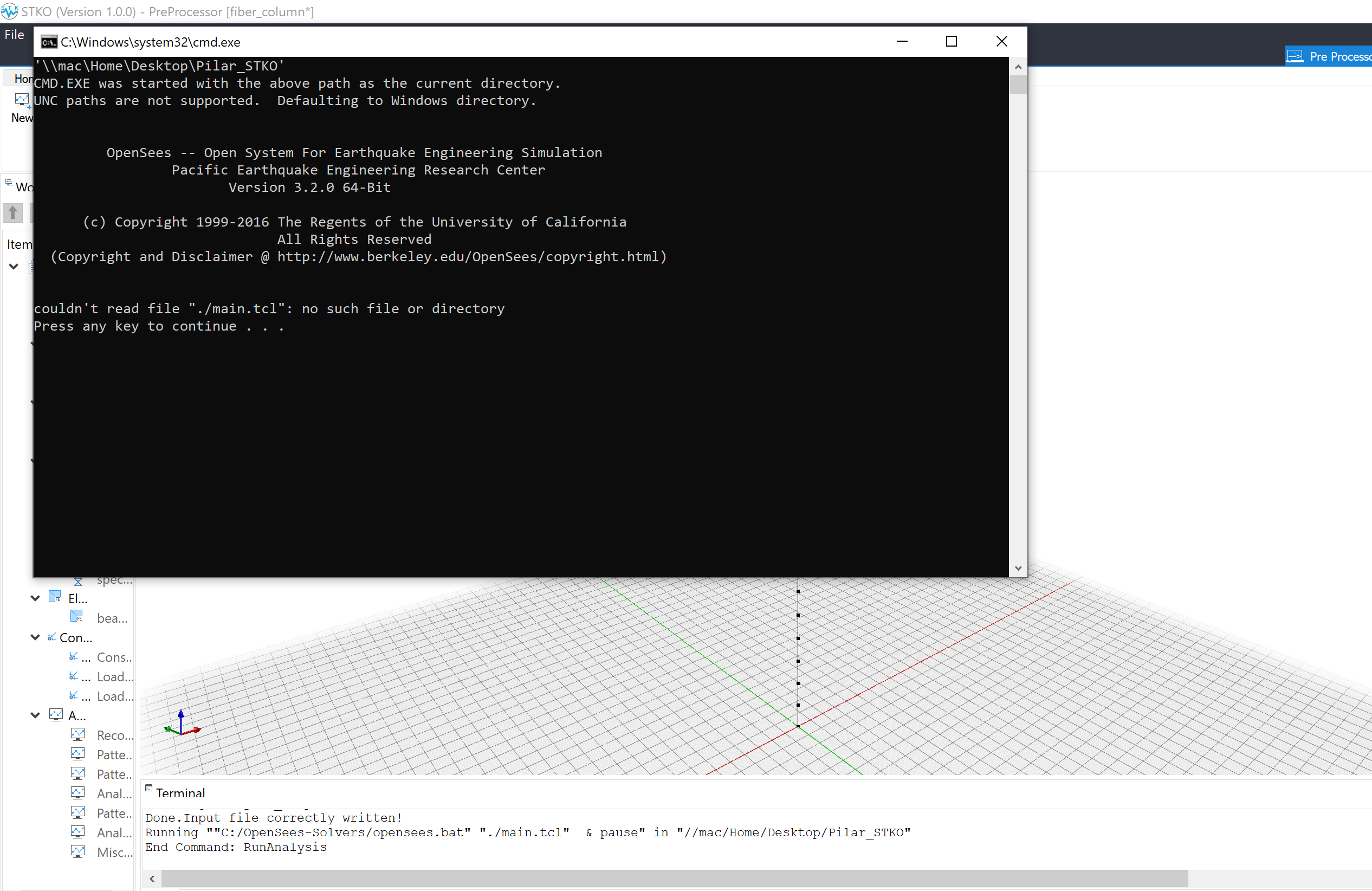

I'm using windows with parallels in my MAC OS. I'm having an error running the O.
can you see my screenshot, anyone solve this issue?

must create a folder in Windows and not as a link to a MacOS folder ('\mac\home\desktop\...)
